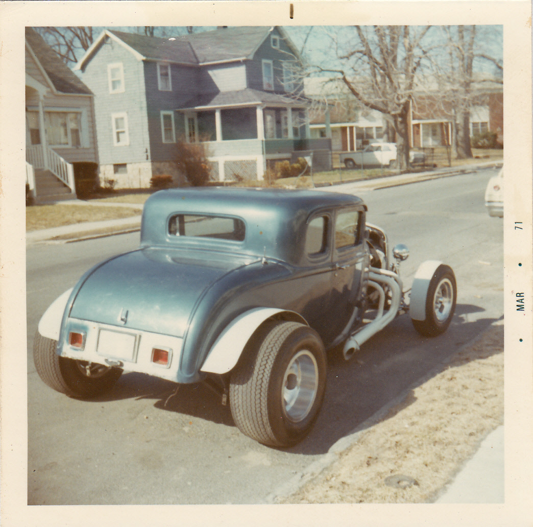

    I hope Tuck doesn't mind if I bump a couple of his pics. These are just incase someone is dragging their feet to read back through or subscribe.
    I love Hot Rods and this build in particular.

  8. AHotRod
    Joined: Jul 27, 2001
    Posts: 12,216
    AHotRod
    Nice work Tuck .... I too love your "inspirational" picture.

  11. Tuck
    Joined: May 14, 2001
    Posts: 5,780
    Tuck
    Tech Editor
    from MINNESOTA
    1. Early Hemi Tech
    Thanks man-! If you're taking about the inspirational pic that running shine posted that's the actual car back in 70 something...
  12. Runnin shine
    Joined: Apr 12, 2013
    Posts: 3,337
    Runnin shine
    Awe man nobody is gonna have a set of those, nice!
    Consider Wyatt(me) inspired.
