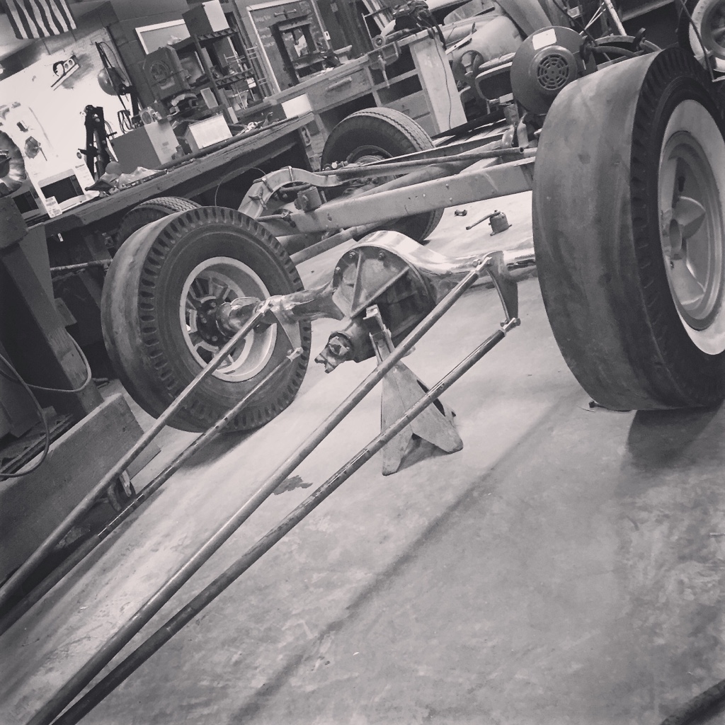

    I got a couple hours with the lathe and started to form up the ladder bars-
    I want them long 60's style so approx half the wheel base- but I'm gonna go a little more, hoping to meet the f-1 crossmember and pedals.
    From what I've been reading you want to put them at the center of weight so being this car will be front heavy I want to get them a little beyond mid point- these brackets on the chrome axle are where they are, they're only slightly triangulated- so I plan to run big bushings on the ends and the fact they will be long rectangles should keep stresses from lifting one tire to a minimum.
    Being they're so long I need to gusset them well-
    I was going to zig zag rod in between but now I'm thinking I'll make gussets that match the front hairpins I made.
    I made these out of 1" .250 wall dom tubing.

    Made a Jimmy White style ladder bar jig to make them identical-
    The sleeves are 1 5/8" OD dom with .187 wall I'll use with 1 1/4 OD bushings-
    Started making gussets today to match my hairpins up front.
    Kevin Bacon calls it a #streethero
    I just need to do a small kick in the back- like 2-3" so I'm gonna keep it pretty simple- I could get away with no kick I think but better to have to go up then down to nail the sweet spot.

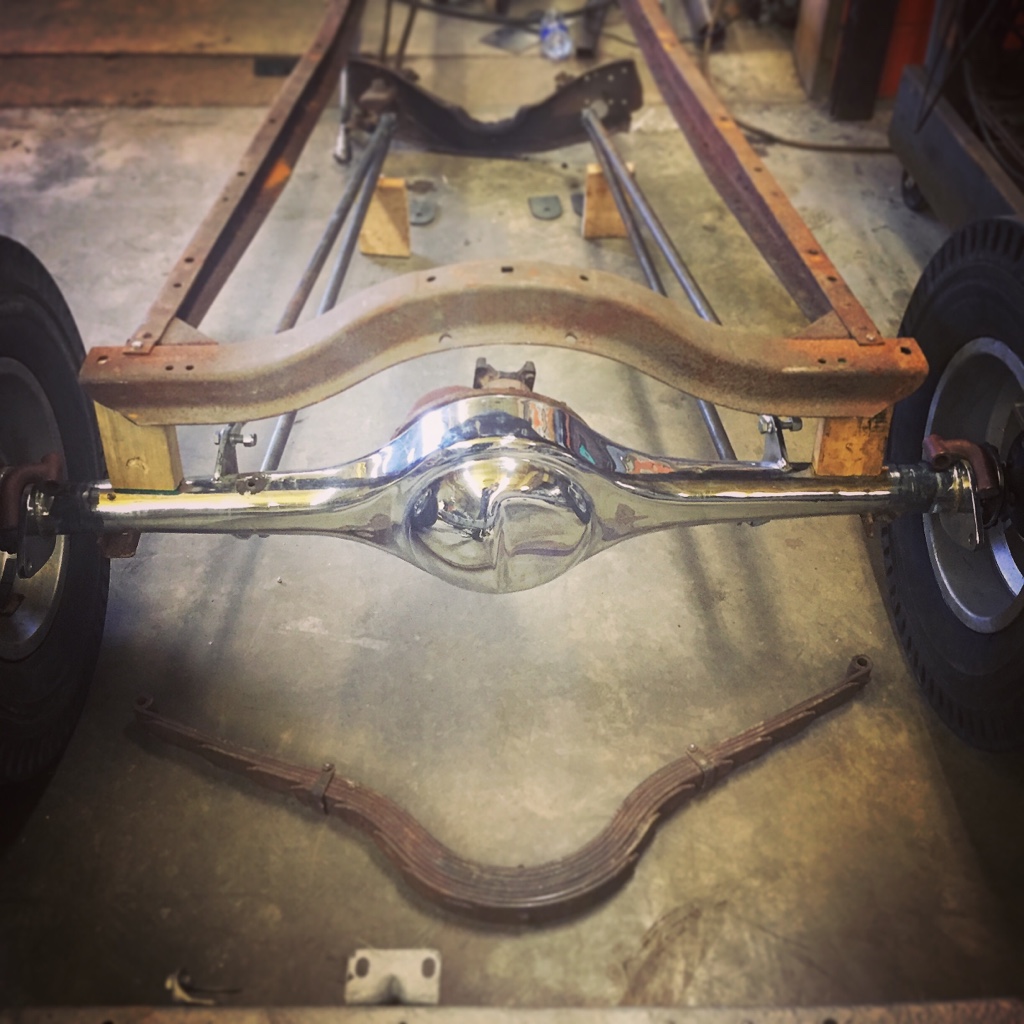

    Just a quick update- I had a day in the shop today and got some time in on this thing- welded the batwings and hairpins and started to blend them smooth... still a lot to do-
    I bought shackles, bushings and got all the hardware for the suspension.
    I need to make the spring over mounts for the rear-
    I bought steel for boxing plates but didn't get to trimming them down yet.
