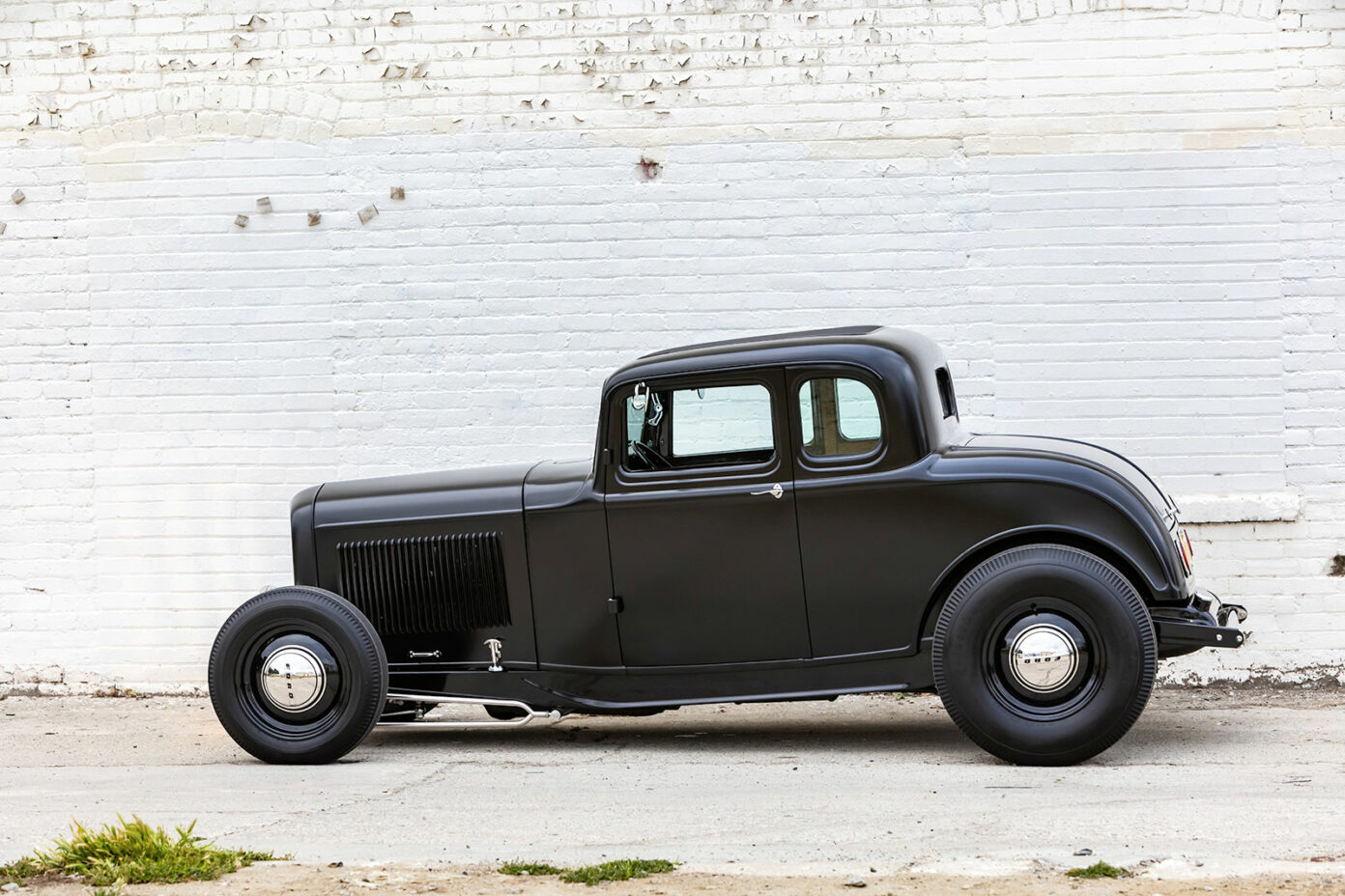

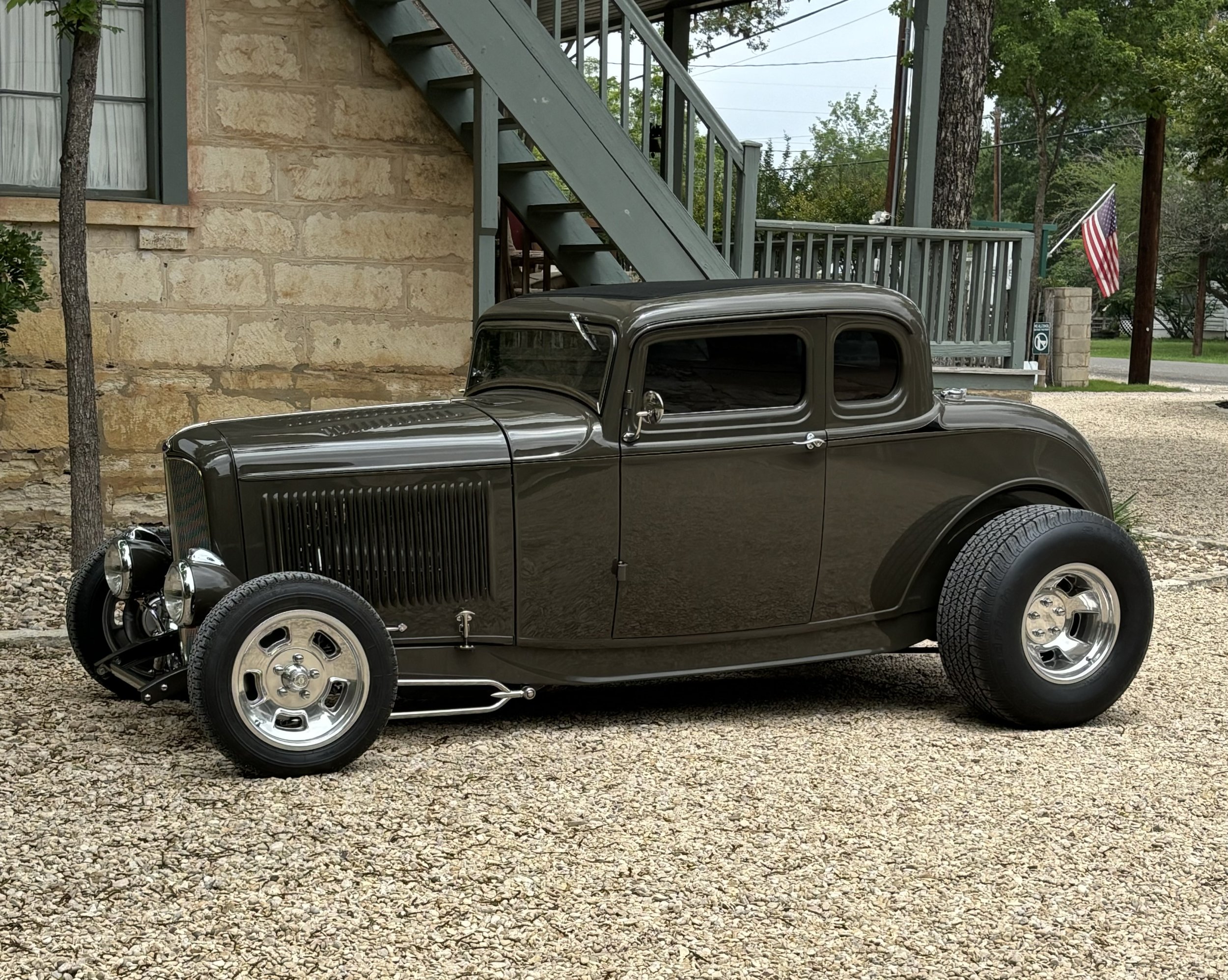

    This car on picture has a 2” chop and you can measure the rear side window that it is square.
    Too low for most ( my guess ) but it’s Very nice.

    nice looking 5 window !

    That is not a 5” chop in that picture. Looks more like 3” to me.

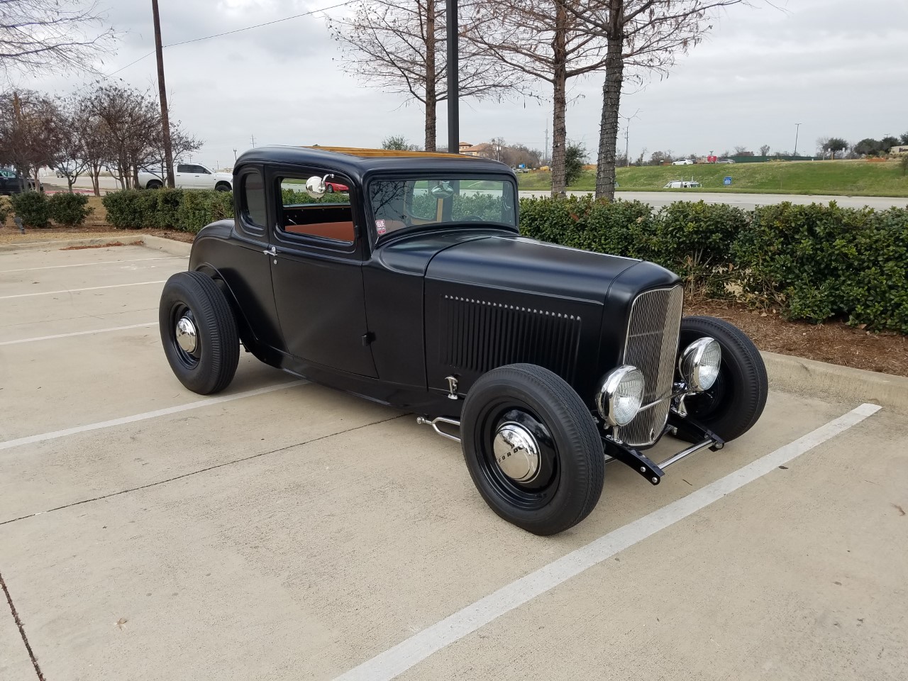

  6. IMG_7978.jpeg IMG_7912.jpeg ] My opinion, if you are not going to chop at least 3" don't bother. My not chopped coupe.

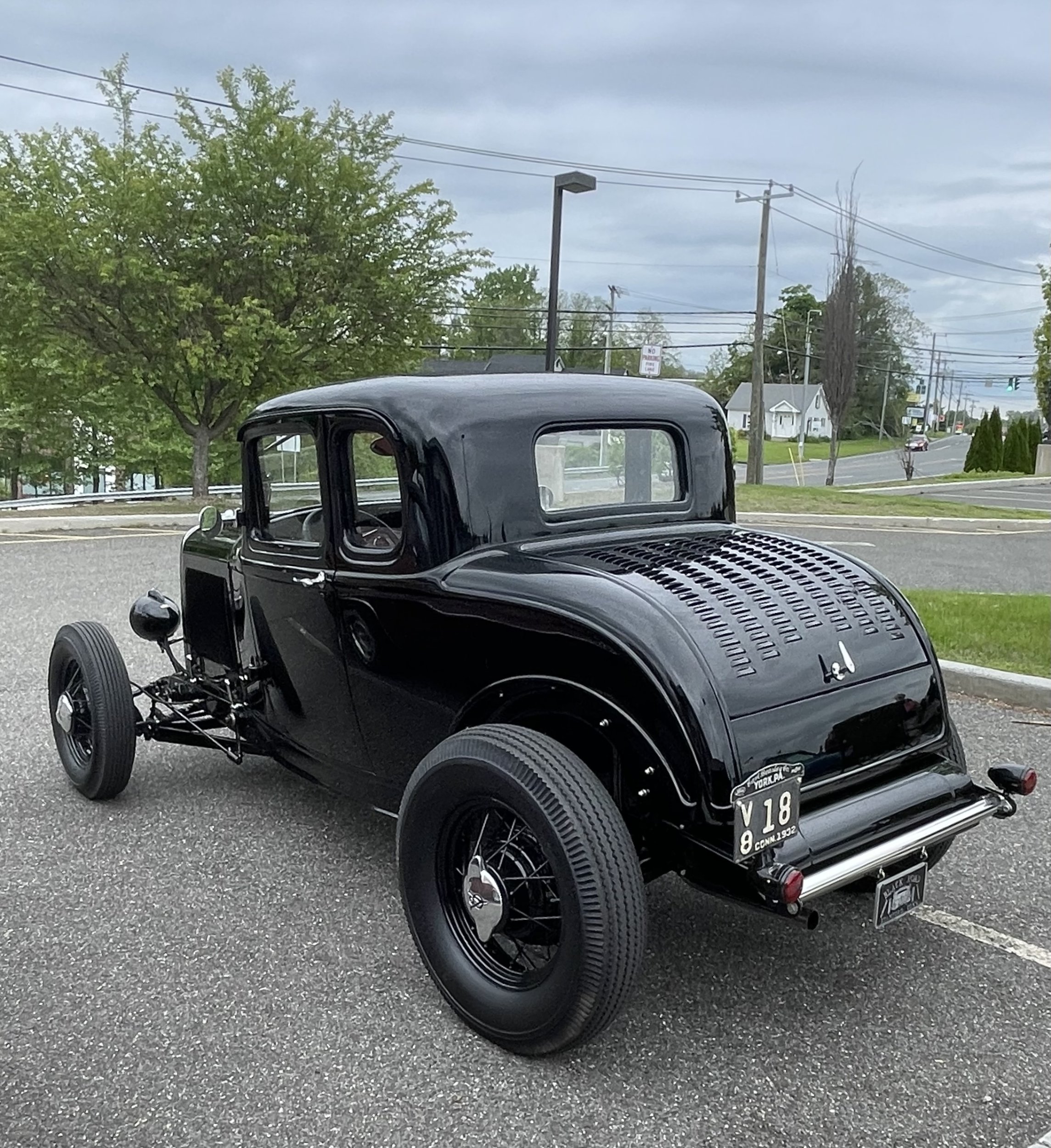

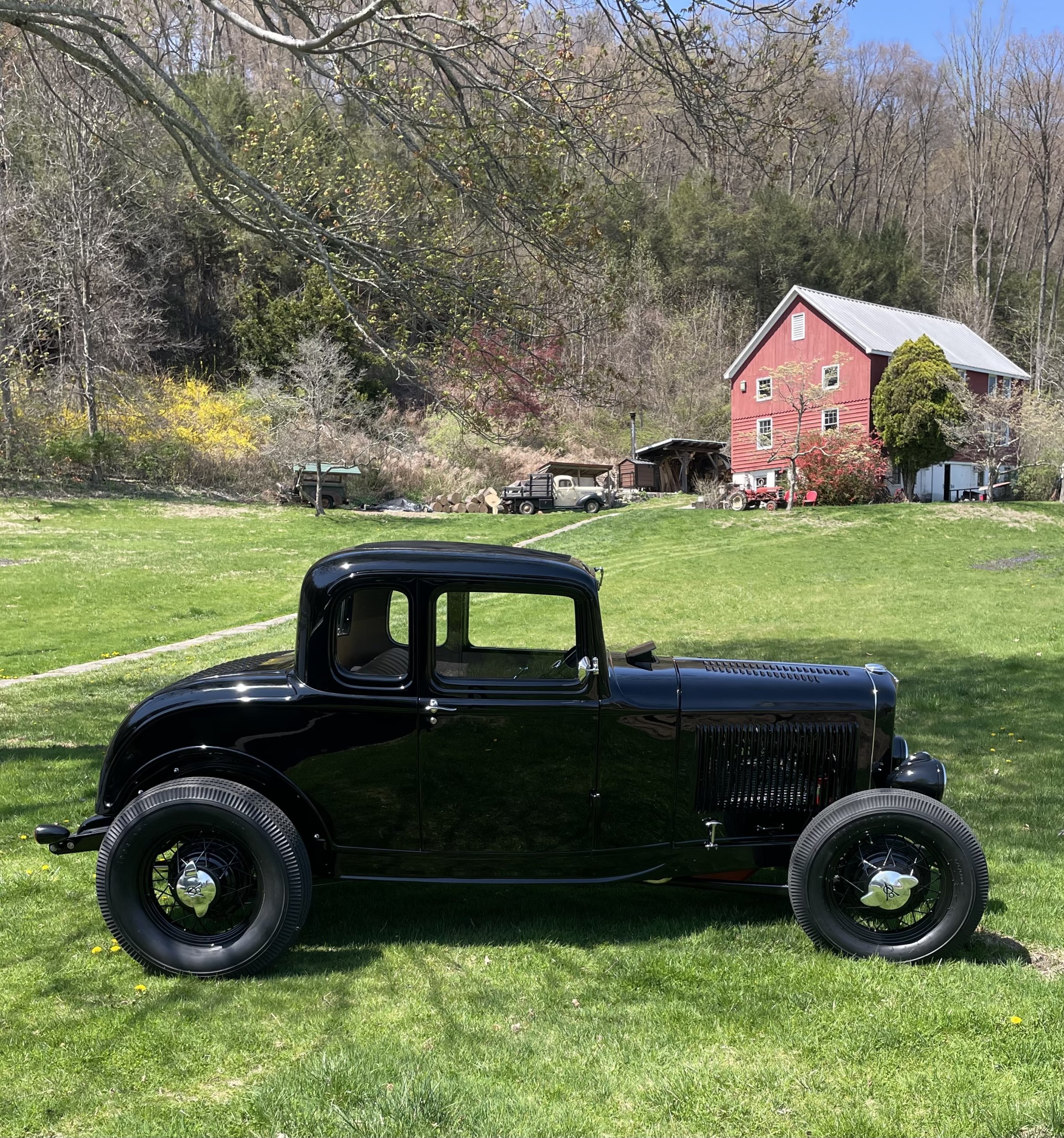

  7. My five-window three-inch chop.

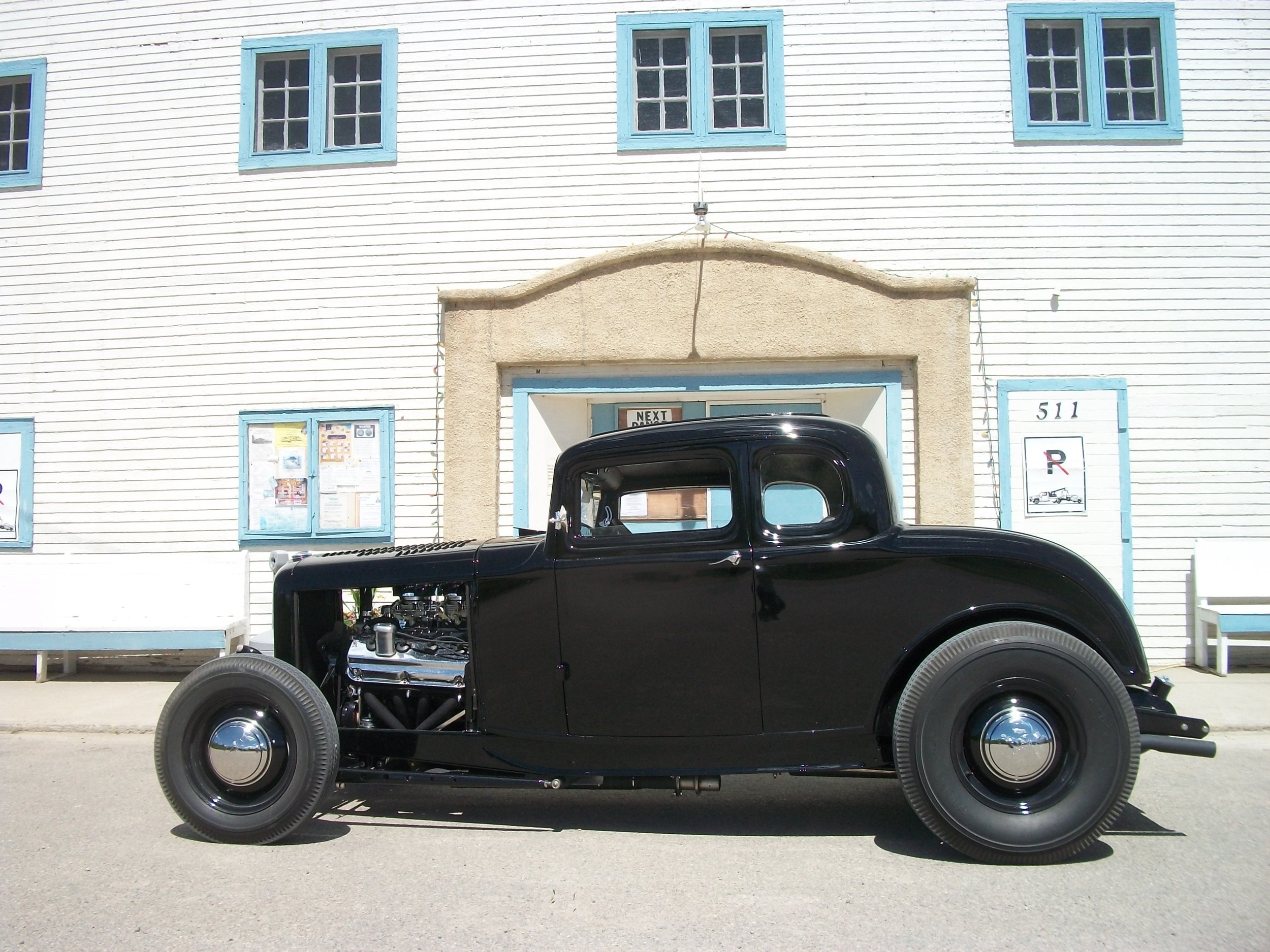

    You already have a 3" chop? 3" is not too low. I took out 3 1/2 out of mine and now wish I had taken 4 or 4 1/2" and leaned back the A pillars a bit but what's done is done. Even stock hieght you still can't see the stop lights anyhow. 100_5821.JPG

    They are all neat! Unchopped, chopped 2”, 3”, 6”, straight down or slanted posts. Doesn’t matter, they all look good. One of the most versatile body styles ever made.

    Both this black coupes are just great, 3" or 3.5", but there is my personal limit at 3.5", but I has been look at 5 or even 6" before, but the idea here was my new insigt that this bodys become so nice to get the rear side window square and that is at 2".
    -But it can be seen as a gentlemans chop or even 'why chop' 2" from std.

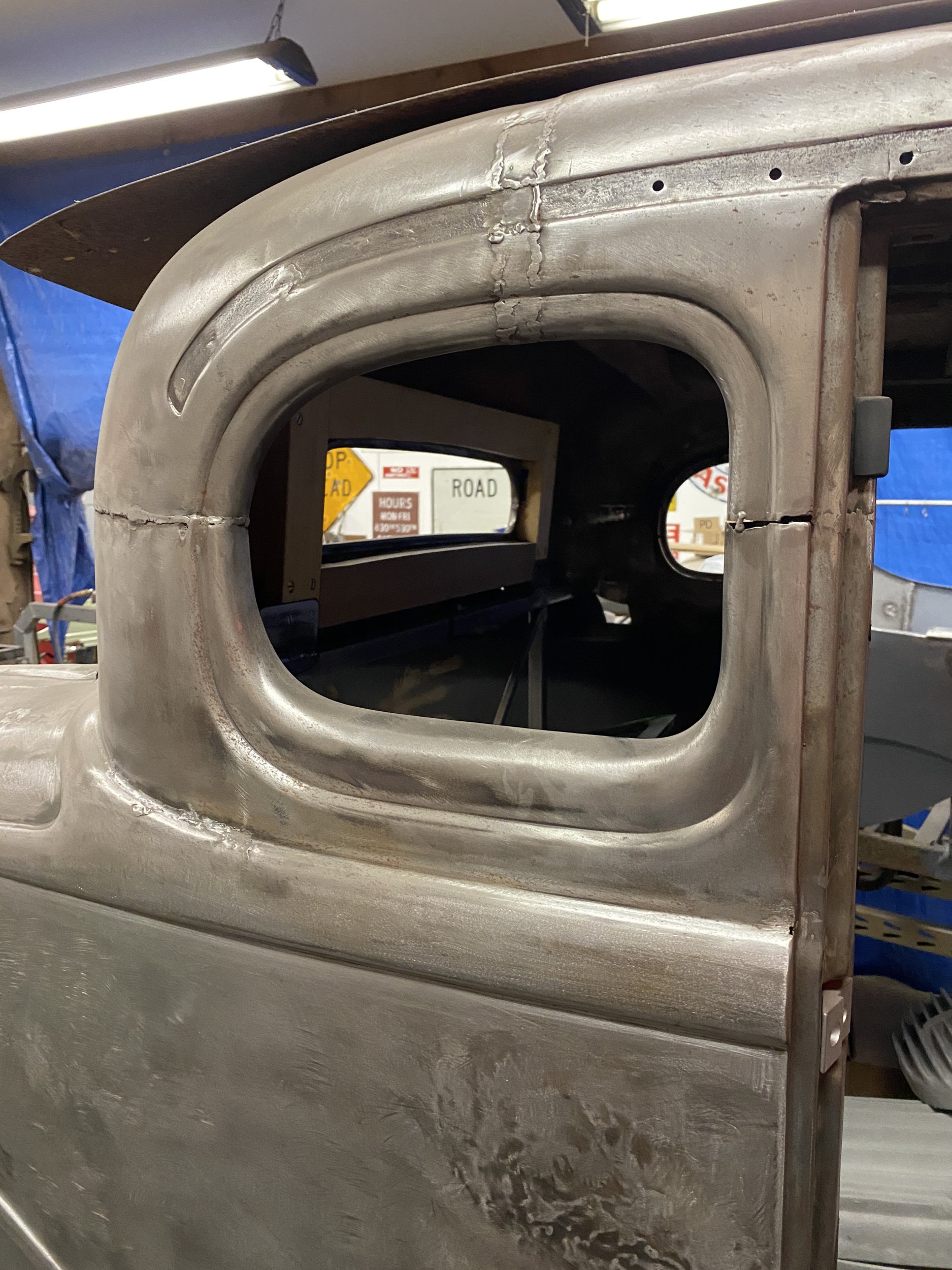

    On Hot Rod Rons coupe the "rear side window" by measure on the computor screen rather equal.
    I can be wrong and its hard to say.
    If a 3" chop height should be 1" less than the width ( by check lower side above the curves )
    My width is 11" ca ; 3.5" upp from lower side of roof.
    From droplist to the upper side of body conture its 387 mm or 15.23".
    I think I has a rather exact 3" chop on this body.

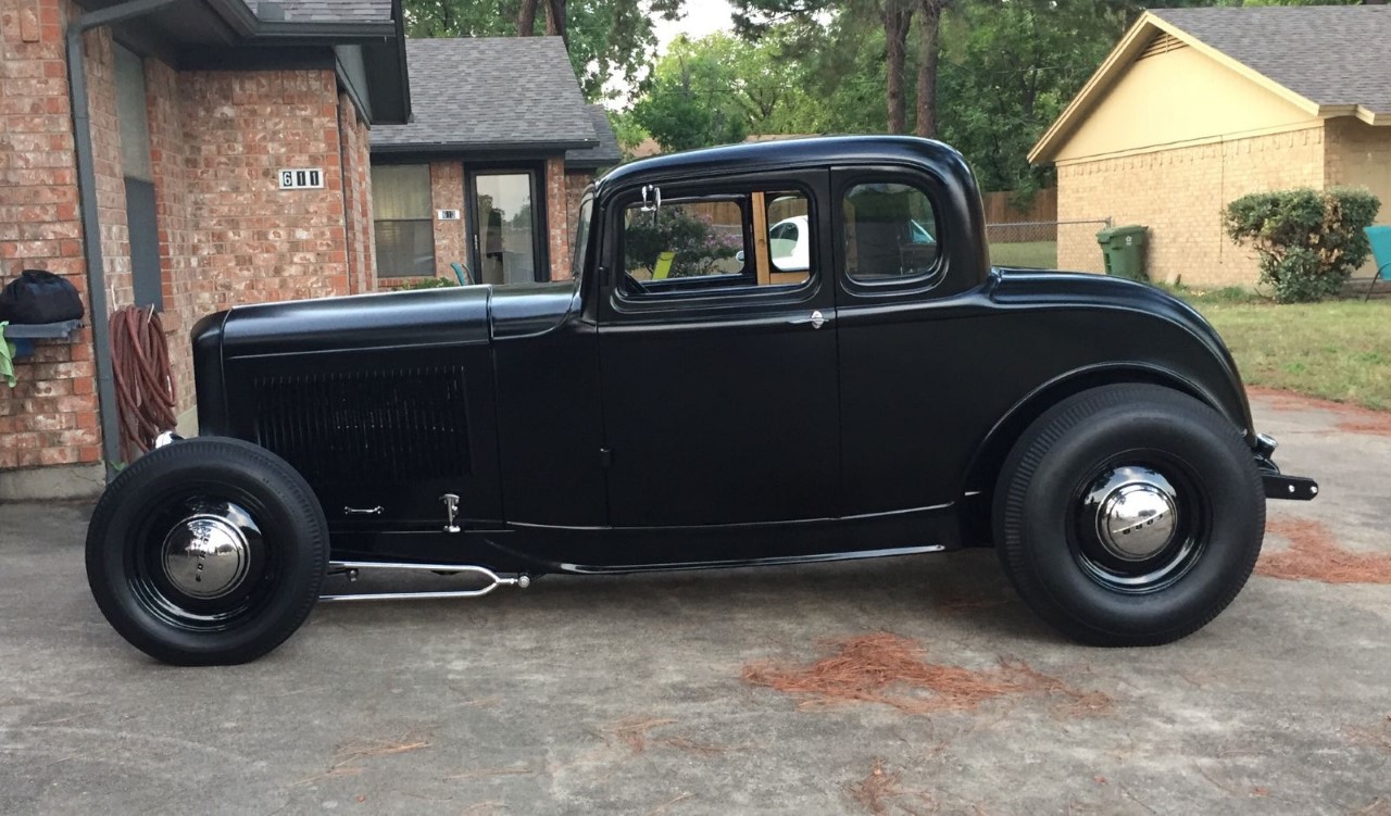

    Hey! That first coupe looks familiar!

    That 2” chop is very nice.
    Rons is as my 3” so height is 1” less than widht.
    This is classic.

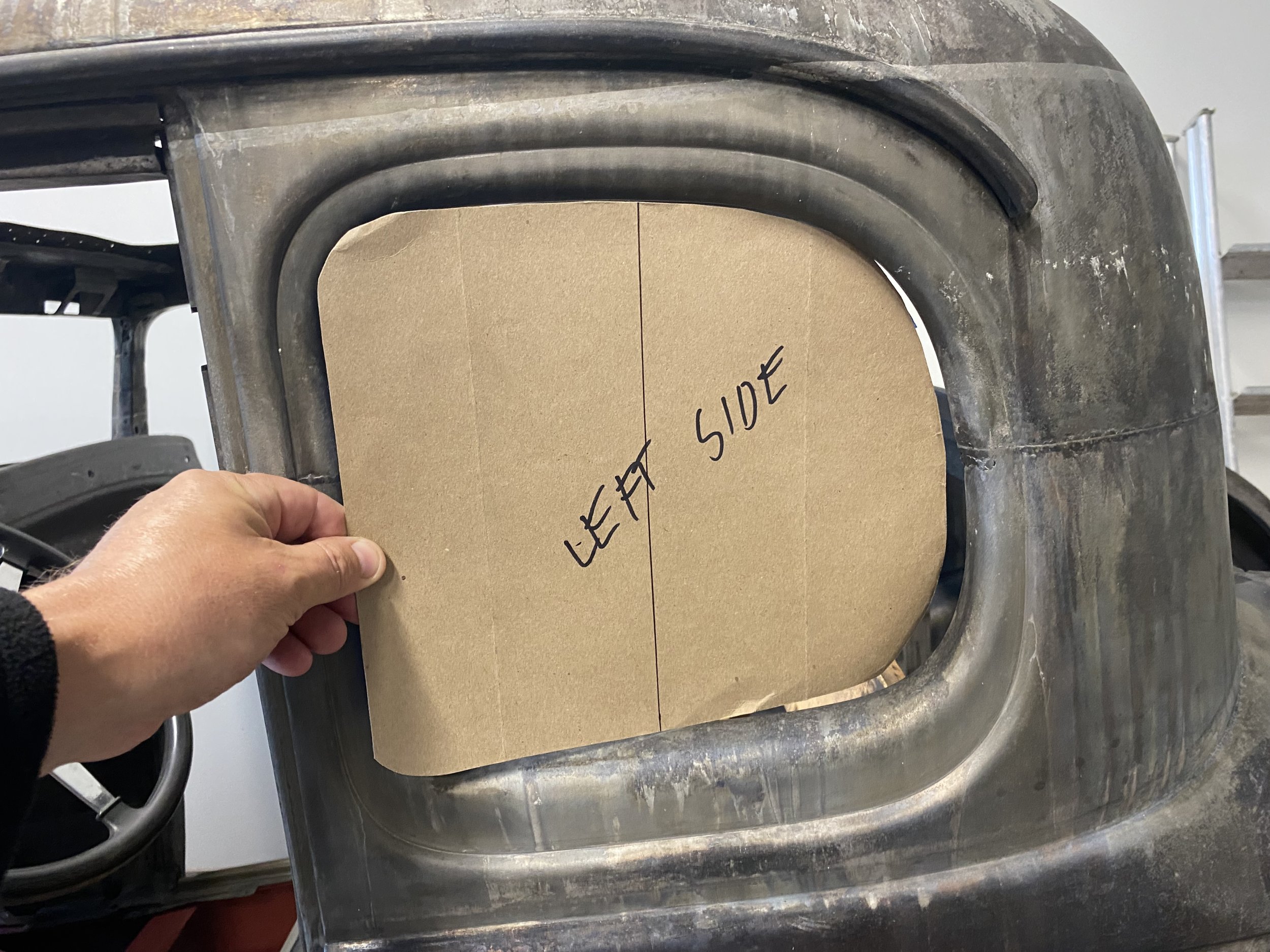

    Got a magazine from Hot Rod Ron on his 3” 5W, and he also sended a temple on his rear side window.
    Cool and thank’s !
    A good thing noted in the magazine I saw his body so I’ll got confidence my body has a good chance to be nice.

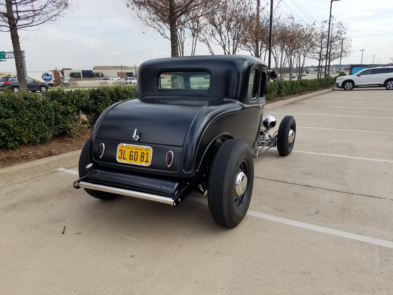

    I wrestled and wrestled with the amount to chop my car. I laid awake at night trying to decide. I've looked and looked at chopped 5 window coupes since 1974. I had it narrowed down to 2" or 2 1/2". I felt 3" was too much. I too felt like the shape of the rear quarter window was the key to what I wanted. Pictures, and picture angles can "distort" the look a lot of times on both mine, and others. Many times I see a picture of mine and think "Oh it's not enough" but in person, I think it's right on what I wanted. If I had it to do over again, I might have taken another 1/2" out, but 1/2" is pretty minor. I'm pretty happy with how it turned out. By the way, as the magazine article says, the chop was done by Joey Angelo while at Walden's. I was assured he was one of the best metal guys in CA. Only after it was done did I find out my car was the first '32 5W he had ever done! I think it turned out great!

    Once I saw your picture above ( wow )
    Your 2” chopped coupe is talking to me, but I feel we might be few to see it this way as most get down under 4” ( and it shore not is wrong )
    So I’ a 2 to 2.5 guy…
