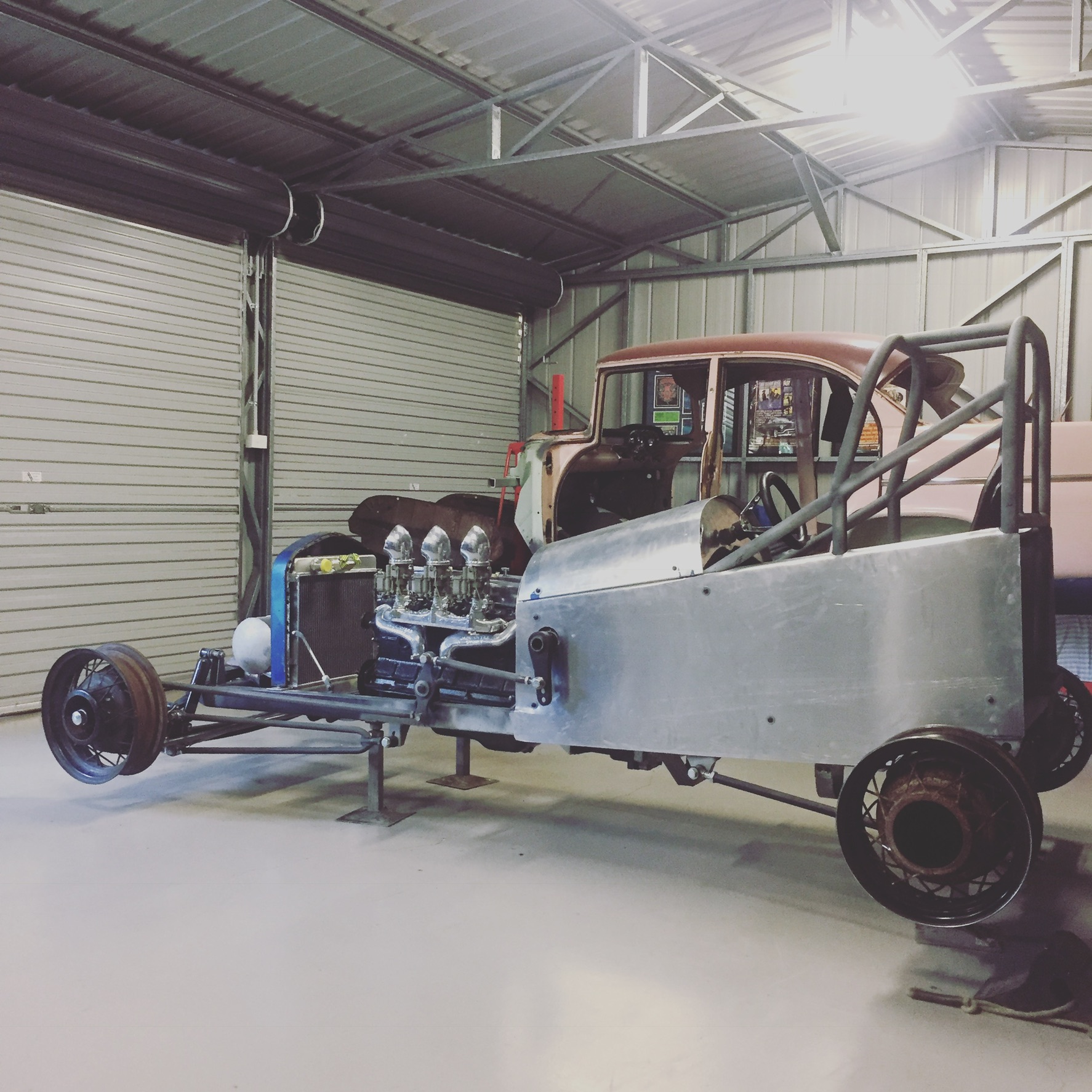

    After borrowing Jeffs notcher again and getting a few more of the gaps closed up hopefully the cage will get through tech once it has been fully tigged up.
    This brings us pretty much to the present day. I'll keep the updates up while I focus on the cooling, fuel and electrical systems.

    Yeah the cage is pretty full on. At least it will be safe I guess? I had to ask the question confirming the inspector knew this is a hambster and not a fuel car.... anyway they are the ones signing the thing off and its all in the name of safety so i just did what I was told... for once..
    Anyway, the cooling system is done bar the fan and water pump wiring.
    The after market radiator had 38mm outlets and all the grey motor stuff is 32mm. Luckily they had plenty of meat in them and after a quick machine i got them down to match while still leaving about 8mm material thickness.
    The alternator conversion is done bar the wiring.
    Hopefully ill have the fuel system done next week once i get some more bundy tube after the first attempt ended up in the scrap metal bin.
    [​IMG][​IMG]
    Sent from my SM-N960F using Tapatalk
