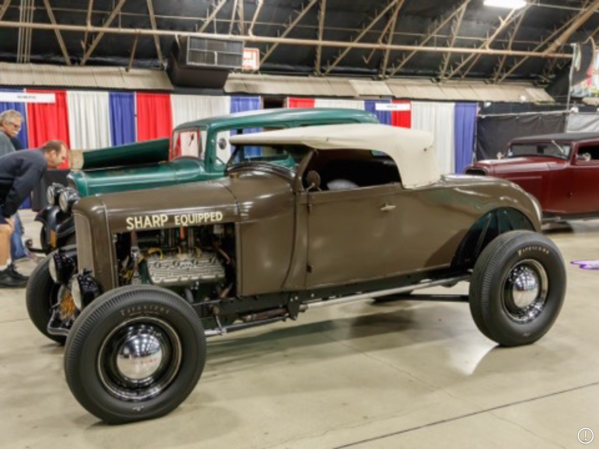

    Here's David and his roadster. You can get the full story here. We'll dive into inspiration a bit more later.

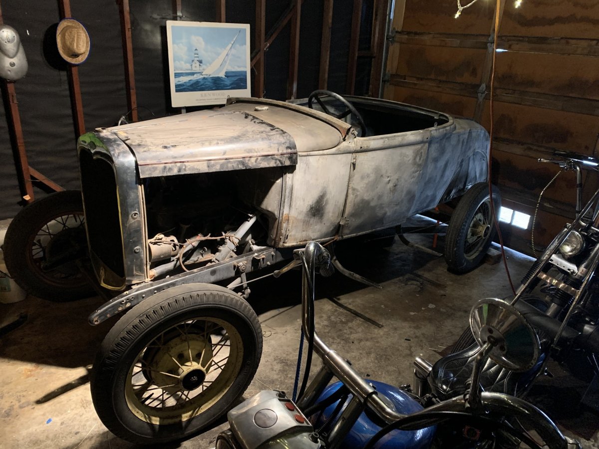

    So my roadster build started with some grimy but overall solid pieces. The car came from Northern California, so there wasn't too much rust to worry about. There are some pinholes that will be addressed in the future, but it's overall solid. The body had been propped up against a wall for decades, and I was encouraged to see how solid the subrails were. The first time I saw it, I thought of an old whitewashed fence. It looked as if it had been painted with house paint! It wasn't perfect and it didn't need to be. It was a good start.
    Dreaming big!

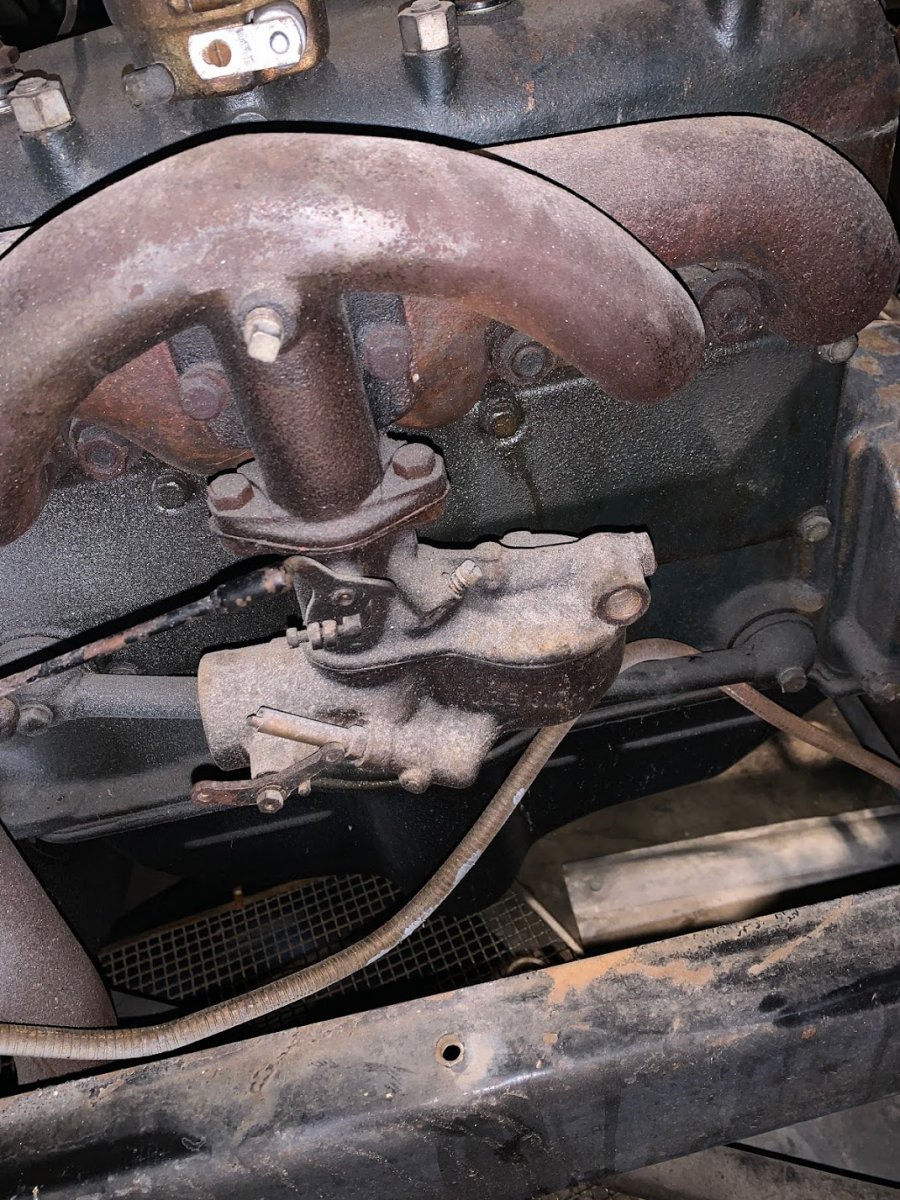

    With the fun and games out of the way, it was time to get down to business. Since the banger turned over, I figured I would hit it with the same strategy that I do for old motorcycles: address each system as individual projects. First and foremost, I removed the Zenith 2 carb for an overhaul.
    Other than the spiders (deceased) the carb wasn't too bad. I gave it the full cleaning treatment.

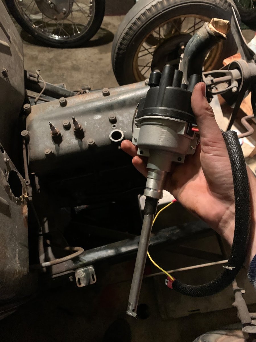

    Next came the ignition. Once I decided that I was going to convert the car to 12V negative ground, I knew that I wanted to run an electronic ignition. I had good luck with that setup on my last motorcycle project, and I eventually stumbled upon FSI for the banger. The installation was pretty straightforward. Finding TDC with the pin in the divot was exactly like on the Triumph, so that made me pretty happy.
    IMG_9680.jpg Out with the olde...
    In with the FSI!
    Next, I scoured the H.A.M.B. and discovered the Full Metal Jacket Odyssey PC680, which should work for both the banger and flathead iterations. Using the stock lower battery box, I created a battery tray. It is insulated with rubber and clamped down so that there is no movement in any direction. The battery box will be painted black.

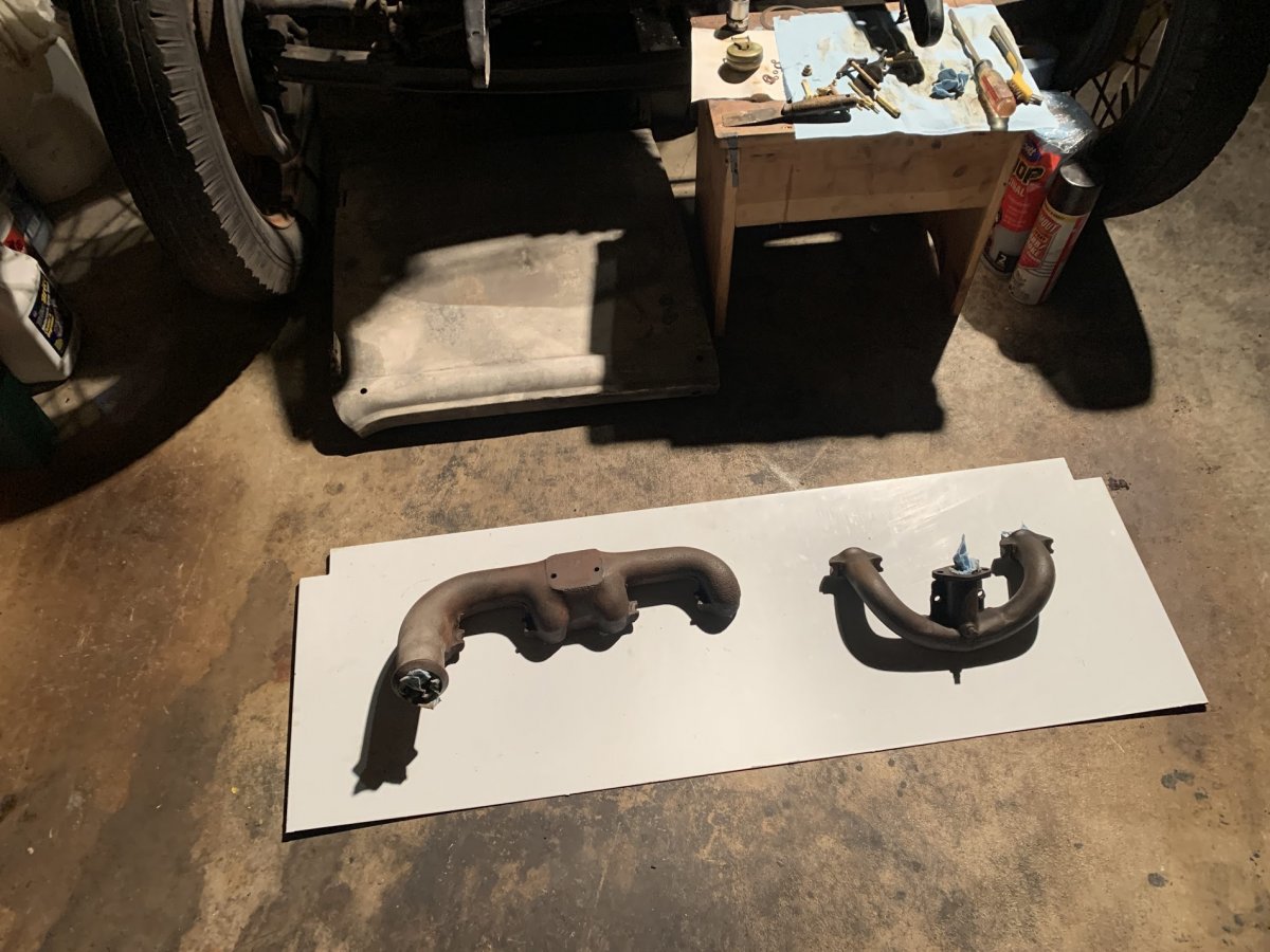

    Around this time, I pulled off the side cover to adjust the valves, test the oil pump, re-lubricate and re-gasket. I was surprised to see that at some point someone installed adjustable lifters. It only took a little bit of cleaning to get things tidied up.
    Part of working on a project that needs absolutely everything is celebrating the little victories. Like getting a radiator cap! That being said, if anyone has an old quail one or a Motor Meter they're looking to part with, let me know.

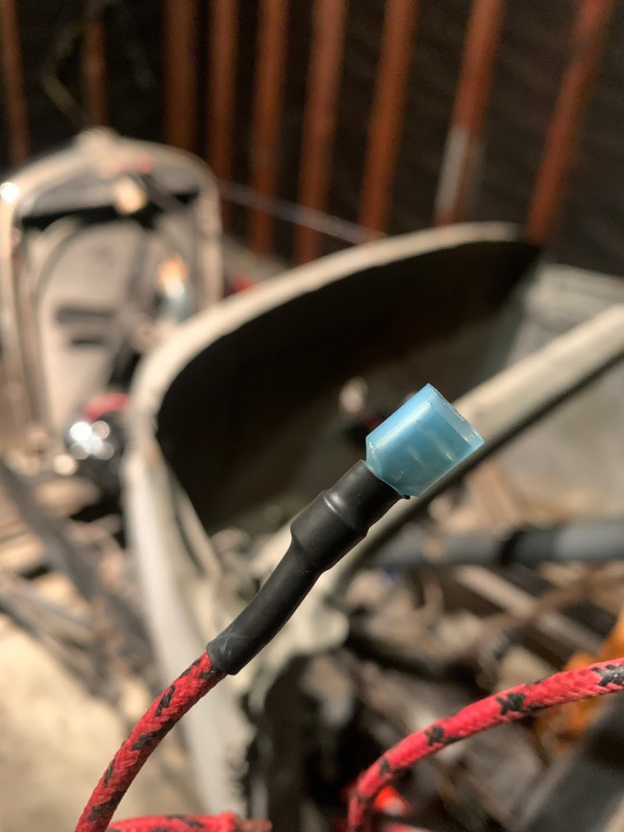

    A note on wiring: All wiring is of the cloth-wrapped variety, correctly crimped and heat-shrunk. Not-so-era-correct waterproof terminals are used in areas that I think may get wet, strangely enough. Out of sight, out of mind...
    I cleaned these up later, but you get the idea. Speaking of cleaning, it felt good to finally get the action side of the engine spruced up.

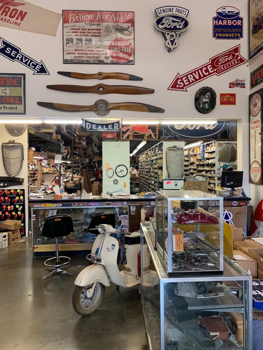

    Got some great hardware/components from my new friends at the All Ford Store in Campbell, California.
