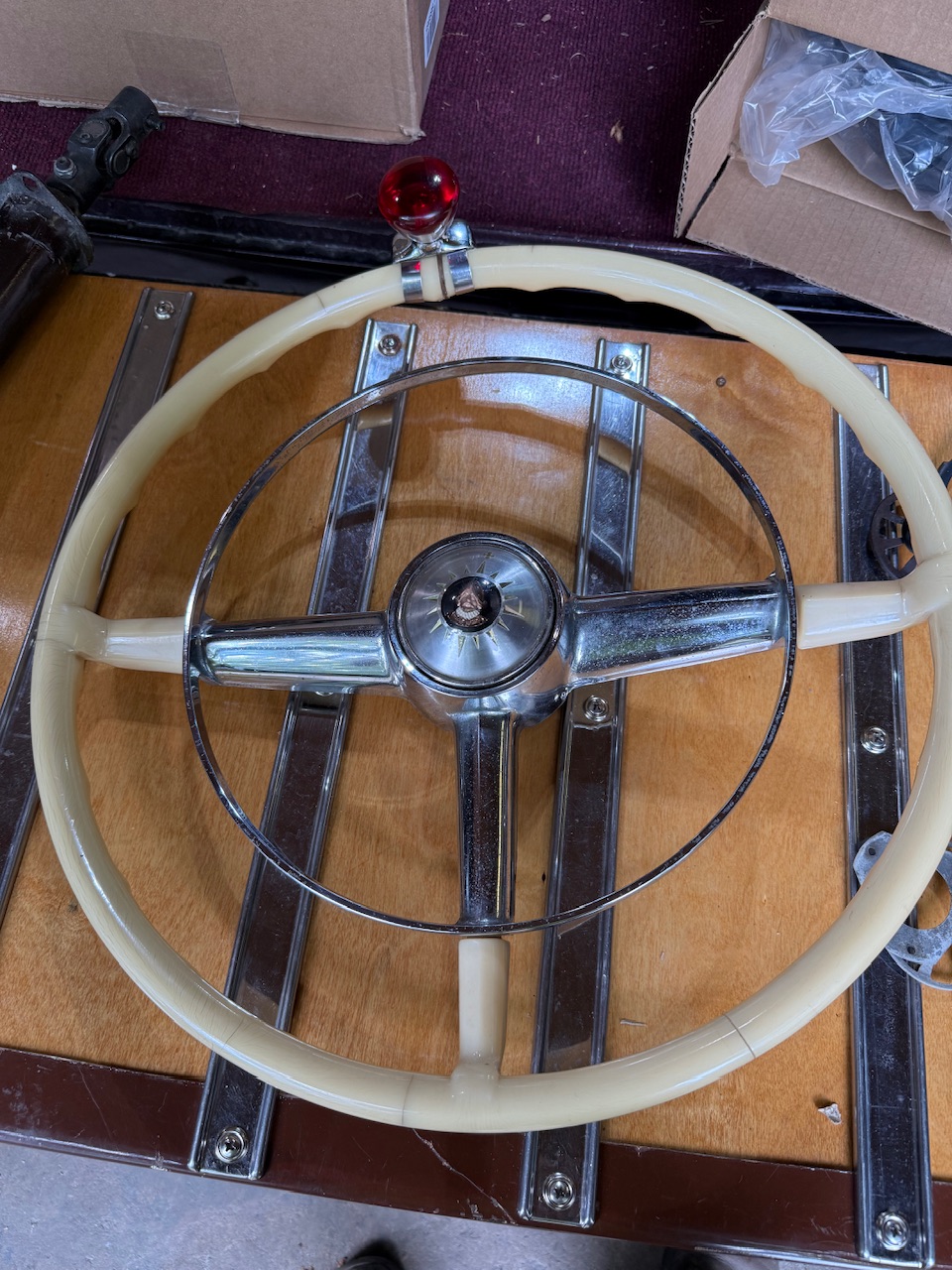

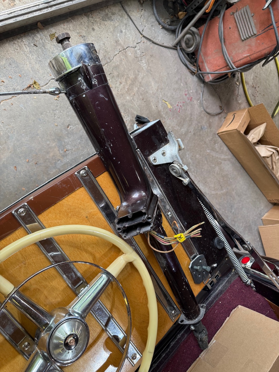

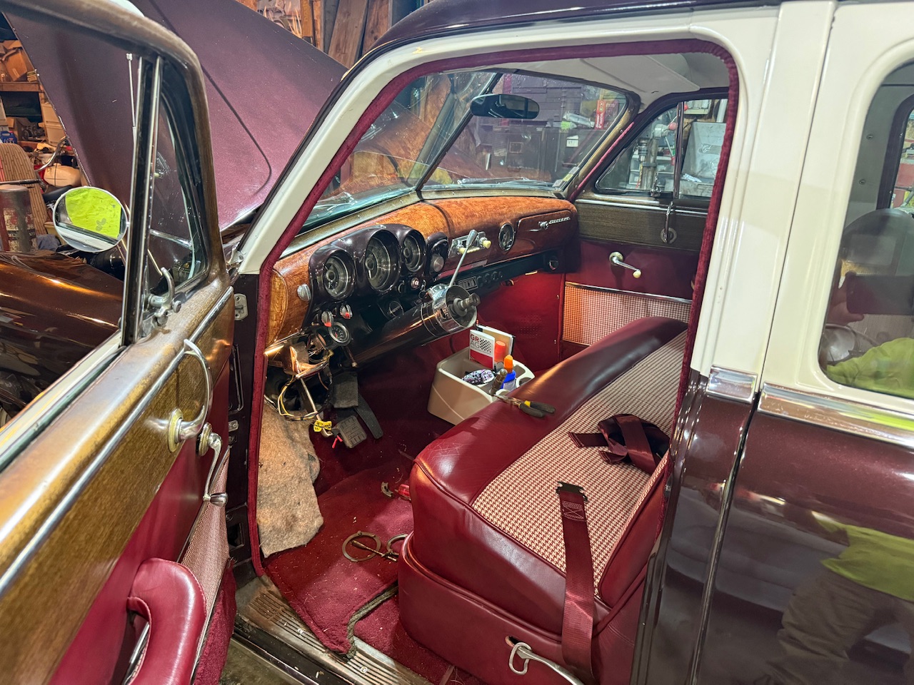

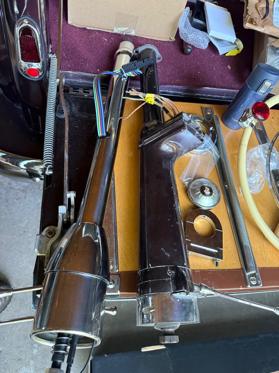

    IMG_3754.jpeg IMG_3755.jpeg IMG_3759.jpeg The turn signals in the DeSoto wagon have been working erratically, and brake lights. Not good since the wagon this replaced was rear ended. Today set about fixing them, I figured it was the switch behind the wheel because when the left side didn’t work (which was almost always) if I momentarily turned the right signal on then came to the left, everything worked.
    I pulled the wheel and started trying to get the switch out, and immediately broke the tiny fiber back of the switch with the contacts. Not a big deal I thought, as it didn’t work anyway, until I started searching for a new one.
    Yikes! They are out there. NOS, for between $200-$300 for the tiny, 70 year old switch. A new column, tilt, with modern guts is half that, and tilt to boot which will make sliding under the steering wheel much easier.
    So, I’m ordering up a SS tilt column, a Chevy butterfly style wheel and now I have two cars down in the shop. The column I shortened to 30” with a double D shaft already, so a new one will be bolt in. As long as I’m ordering from Speedway I’m getting a white, 3 spoke ‘flake wheel for the Impala. Might as well work on ‘em all…

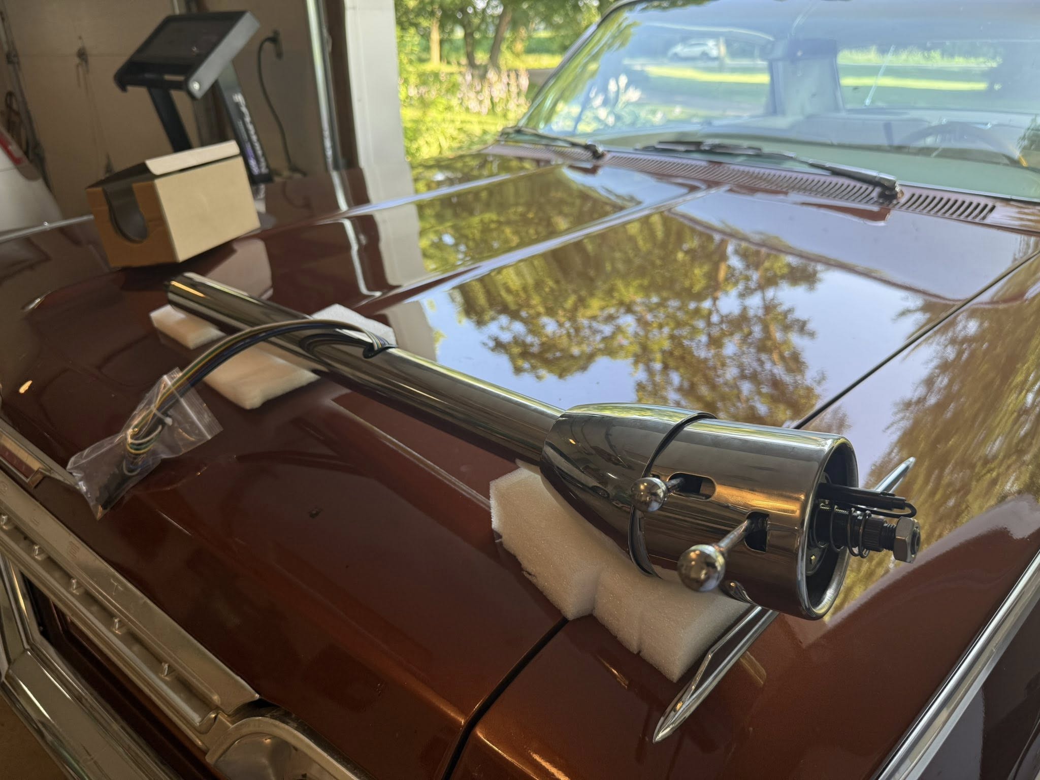

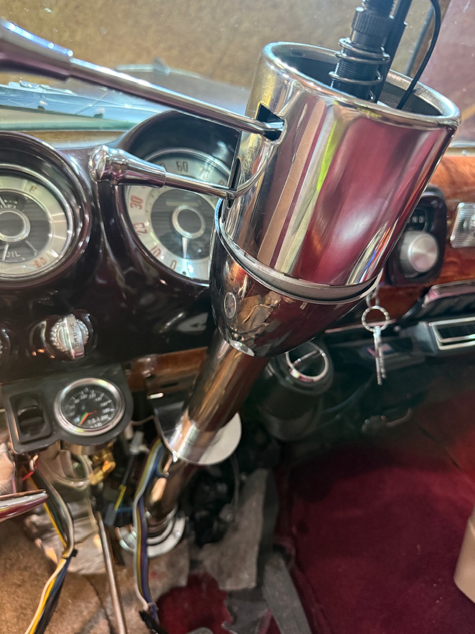

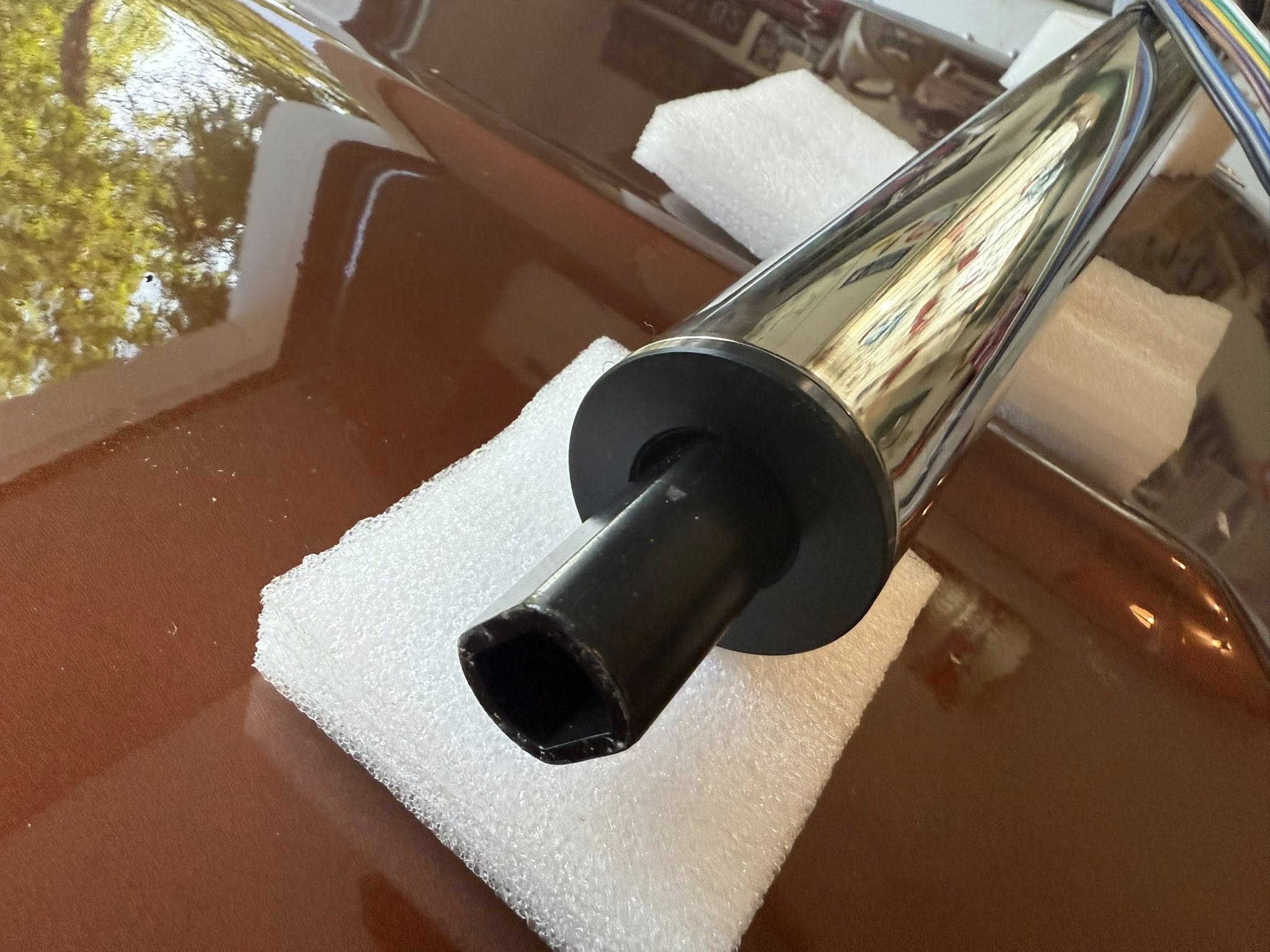

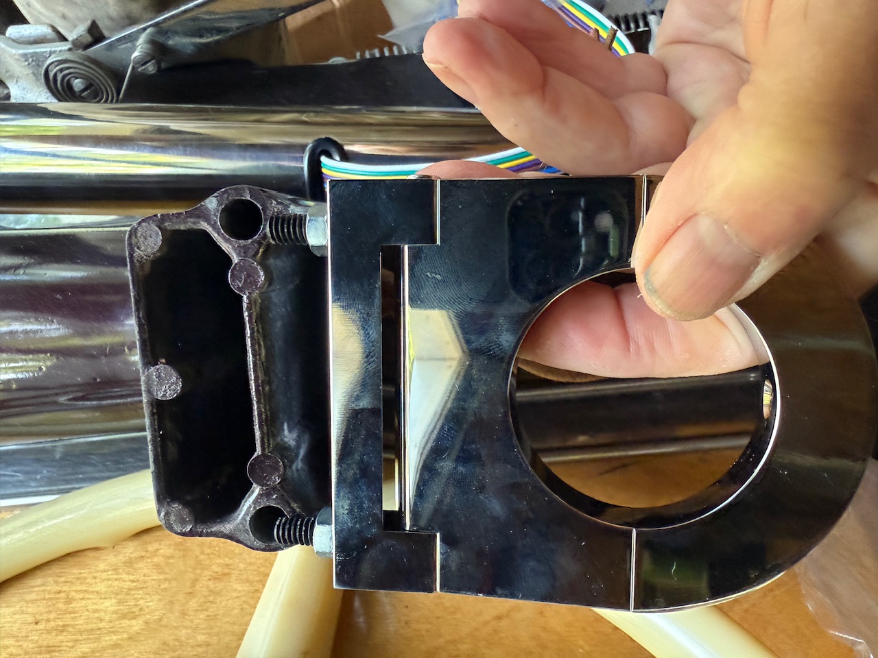

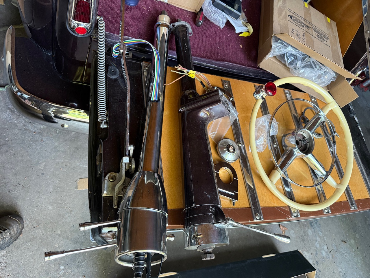

    The steering column arrived today. The length is the same. The double "D" shaft is the same. The column drop I bought has bolt hole centers the same as the originals. The swivel base mount will fasten to the floor board by drilling 4 holes. The wiring will connect, with he same color coding as the new harness in the car, with a handful of connectors. I fail to see a downside here. 4B6C3217-8ABD-4407-958D-01A665A766B7.jpeg 509BD6FA-0B3F-4AC7-95C3-9DA317C2A5DB.jpeg 4B6C3217-8ABD-4407-958D-01A665A766B7.jpeg

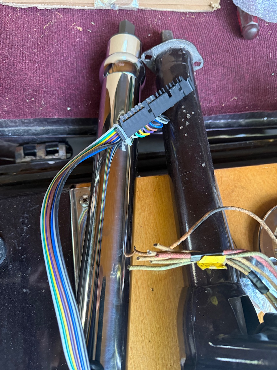

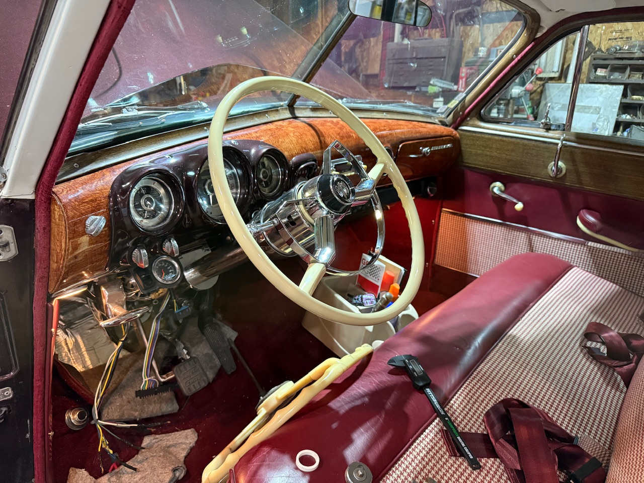

    I don’t think it’ll be an issue, the wiring harness uses the same color wires for the steering column harness, I had traced out and ID’d the linen wrapped wires in the OG harness, and, had in not been for the worn out switch, they worked properly. If they don’t, it’ll be relatively easy to swap the connectors until I do. I thought it was handy that whoever made the pretty column drop used a ‘52 DeSoto mount as a pattern as it’s the same bolt pattern. The steering wheel, ‘53 GMC ‘butterfly” wheel, should be here today. I can’t use the beautiful DeSoto ivory wheel as the splined shaft is 3/4”, the new column has the standard 5/8” shaft. I’m excited to get it back together!
    Bandit Billy likes this.
  14. flynbrian48
    Joined: Mar 10, 2008
    Posts: 8,644
    flynbrian48
    For all y’all who said it wouldn’t “bolt right in”, I don’t mind saying “I told you so”. ;) Just waiting now on the wheel and plugging the turn signal/flasher harness in.

    No slop or play in this at all. I’m very pleased with how this fit, looks and the finish is excellent. No complaints at all.

    I’d been putting off attending to the turn signals erratic function too long, and hated the huge wheel too close to the seat since I built the car. This addresses both issues at the same time. In addition, the column still had the factory shift lever, which isn’t used now, and lastly the chrome plating on that and the turn signals stalk was long gone. The cost was pretty reasonable for the benefit, and I really like new steering wheel I ordered, which should be here tomorrow. The column is beautifully polished and compliments the interior. It’s a winner. We have a week long camping trip coming up, I should be able to it all buttoned back up so we can use the car instead of the Diamond T truck.

    I didn’t have an old motor home to cannabalize, I hate U-pick yards, and I love polished stainless. For those reasons, and the price, around $200 and free shipping, along with being able to get exact length I needed, this clicked all the boxes.

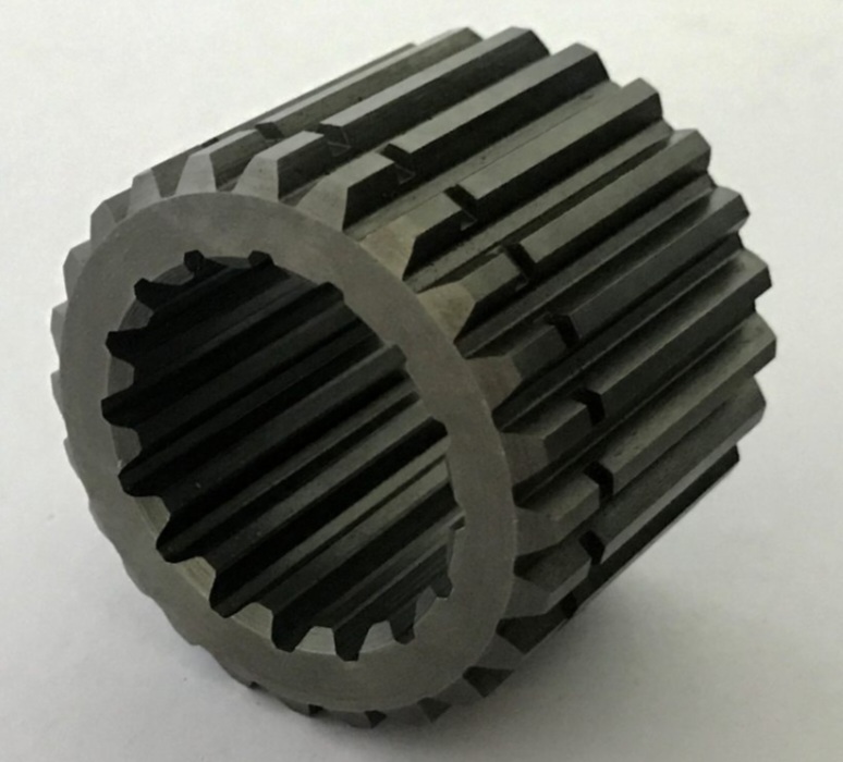

    If you still want the big Desoto wheel, perhaps getting an adapter is doable. Screenshot_20250716-123437_Chrome.jpg

    trouble is that splined bushing would be about tinfoil!
    flynbrian48 likes this.
  25. flynbrian48
    Posts: 8,644
    flynbrian48
    Yup. Not much meat between 5/8" and 3/4". I've got a beautiful GMC pickup "Butterfly" wheel on the way. Actually it was supposed to be here today...

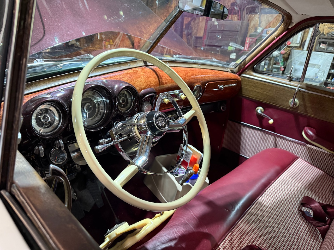

    IMG_3802.jpeg IMG_3803.jpeg The new wheel arrived today, I couldn’t wait see how it was gonna look. It’s made to fit an early 50’s Chevy truck column, so it kind of snuggles down into the much larger diameter collar in this one. That’s fine, but it means I can’t use the horn ring in the wheel. I didn’t have the other one hooked up either. I think it looks great. IMG_3802.jpeg IMG_3803.jpeg
