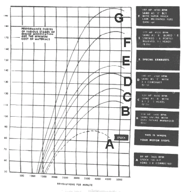

    A 89HP at 3600RPM - Stock 100HP Ford flathead V8 (corrected)
    B 114HP at 3800RPM - Same engine with dual intake manifold.
    C 124HP at 4000RPM - Same as B with 8.5:1 compression heads.
    D 140HP at 4400RPM - Same as C with 3/4 race camshaft.
    E 145HP at 4500RPM - Same as D with special exhausts.
    F 177HP at 4500RPM - Same as B, bored 1/8 inch, stroked 1/8 inch, ported, relieved, 9:1 heads.
    G 197HP at 4700RPM - Same as E but with super track cam and methanol fuel.
  18. gimpyshotrods
    Joined: May 20, 2009
    Posts: 24,414
    gimpyshotrods
    I am going to say something that is not popular here:
    The words flathead, high-performance, and affordable do not belong in the same sentence.
    Look at that chart above. To get to all of 197hp, you would be spending cubic-dollars.

    Sometimes these charts are really meaningless. They may give an idea, but I find what's not on the chart, the real story.
    There's a lot of data missing. Really, it's like answers to questions unasked. We really don't know who, where or when. All we get is a bunch of whats.
    What engine? 59A?8BA?
    Corrected? Corrected how?
    What are the test parameters?
    What ignition?
    Was it tuned up?
    How was it tuned?
    Special exhaust. What's that? So, were the previous tests done with the stock crossover exhaust?
    "B 114HP at 3800RPM - Same engine with dual intake manifold."
    An engine is a lot like a firearm. More Powder, More Boom, but that's not the whole story.
    Now you can take a stock 8BA, throw an intake and 2 pots on it, do nothing to the ignition and you'll probably have a significant increase in HP even with non-functioning ignition advance.
    Will the engine rev? Sure!!! It'll scream like a Banshi.
    Will it make more power? Yeah, especially if you set the now non-advancing distributor "in the middle".
    More Gas, More RPM= More Power but is this really the whole story?
    I'm sure it's great for a "static" test. What about drivability?
    You see there's more to it.
    My hypothetical engine with 2x2s with the stock not working or not working properly ignition advance, may make more HP on the flat.
    What about driving up hill? What about under load? Is it getting too hot? Now it's fouling plugs....
    I really believe that part of the "Flatheads run hot" reputation is from improper ignition advance. In other words, the ignition is not in tune. Even stock engines can suffer from this if they are not kept in tune.
    I can't tell you of the 8BAs and other LOM Fords I have seen on here and on the street with 4bbls, 2x2s and even 2x3s with nothing done to the stock ignition. No mods, no nothing just an incompatible carburetor or 2 or 3 pots put on top.
    That chart is great. Great for selling intakes, heads, carburetors, cams and paying for the machinist's bass boat.
    Below is what I would like to see on a "Chart".

    road test...
    C.
    The same car tuned, with headers and dual exhaust.
    dyno...
    road test...
    D.
    The same car with a Mercury Intake with the LOM compatible Holley 885 2bbl
    dyno...
    road test...
    E.
    The same car, back to the Ford 94 but with the Ford accessory 8BA LOM dual points.
    dyno...
    road test...
    F.
    The same car with 94, LOM dual points, 8BA heads milled
    dyno...
    road test...
    G.
    The same car, Mercury 885, dual points, heads milled
    Dyno...
    Road test...
    H.
    The same car with an intake, Thunderbird 4bbl Teapot or early LOM compatible Carter 4bbl.
    dyno...
    road test...
    But...m
    y chart does not sell a bunch of speed parts, does it? ;)

    Customarily "corrected" means standardized for sea-level atmospheric pressure of 14.696psi, or 1013.25 millibars, and I forget what temperature.
    This is done because not all test equipment happens to be located at sea-level. Without doing that, there would be no way of comparing test against each other.
    If you test the same engine in LA, in Denver, you are going to get two different readings.
    F-ONE likes this.
  28. gimpyshotrods
    Posts: 24,414
    gimpyshotrods
    NTP: Normal Temperature and Pressure is 68ºF and 14.696psi.
    In Metric, that is: 20ºC and 1bar (101.325kPa).
    Formula:
    p = 101325 (1 - 2.25577 10-5 h)5.25588
    where
    101325 = normal temperature and pressure at sea level (Pa)
    p = air pressure (Pa)
    h = altitude above sea level (m)
    Budget36 and F-ONE like this.
