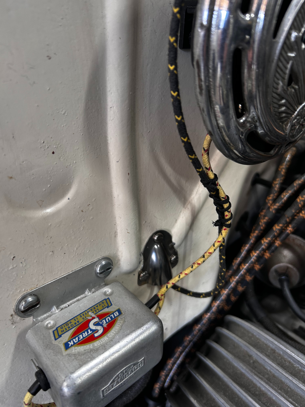

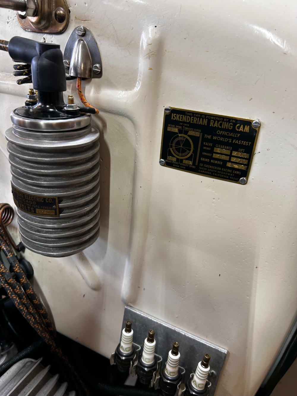

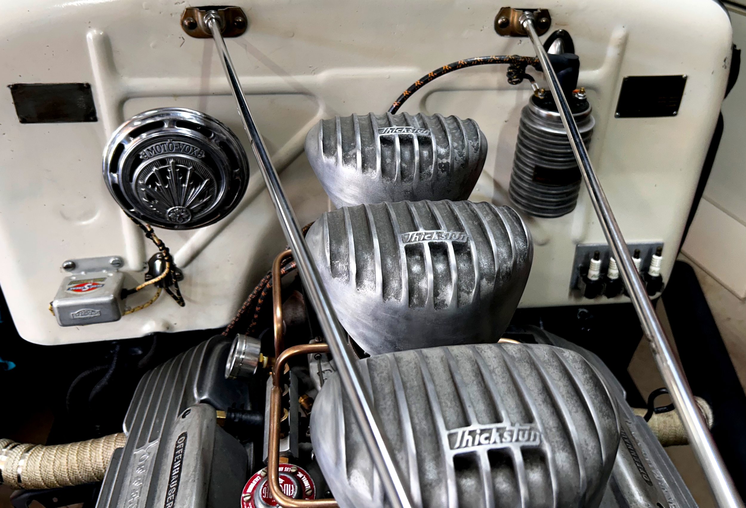

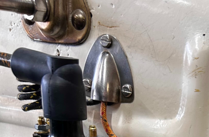

    And this is microscopic - in the whole scheme of things....but thought I'd throw it out there in case there was any interest. Had a couple of vintage mini stainless marine clam shell vent covers laying around from my uncle's old boating days. On a lark, I stuck one over a wire pass thru on my firewall and liked the look. They were polished stainless (looked chromed), so I soaked them in Lysol toilet bowl cleaner to take the shine off and then buffed with 4/0 steel wool. Came out looking like nickel. Now, not sure if half a dozen of these would look right plastered all over a firewall covering multiple pass thru pieces.....but I like the look of these two (most all of my wiring goes low thru the bottom of the firewall). They come in all shapes and sizes and "used" are usually pretty cheap.

    Looks way better than a big ugly rubber grommet

    Looks good, kinda reminds me of 53-56 F-100 taillight wiring shields. I used one of those on my wiring loom out of the firewall on my F-100.

    That's a marine hole cover for antenna wires. Keeps water from running in.

    Looks great, so does everything else in that pic.

    Haha…you would hate the aluminum on my engine then!

    Flat head screws too.

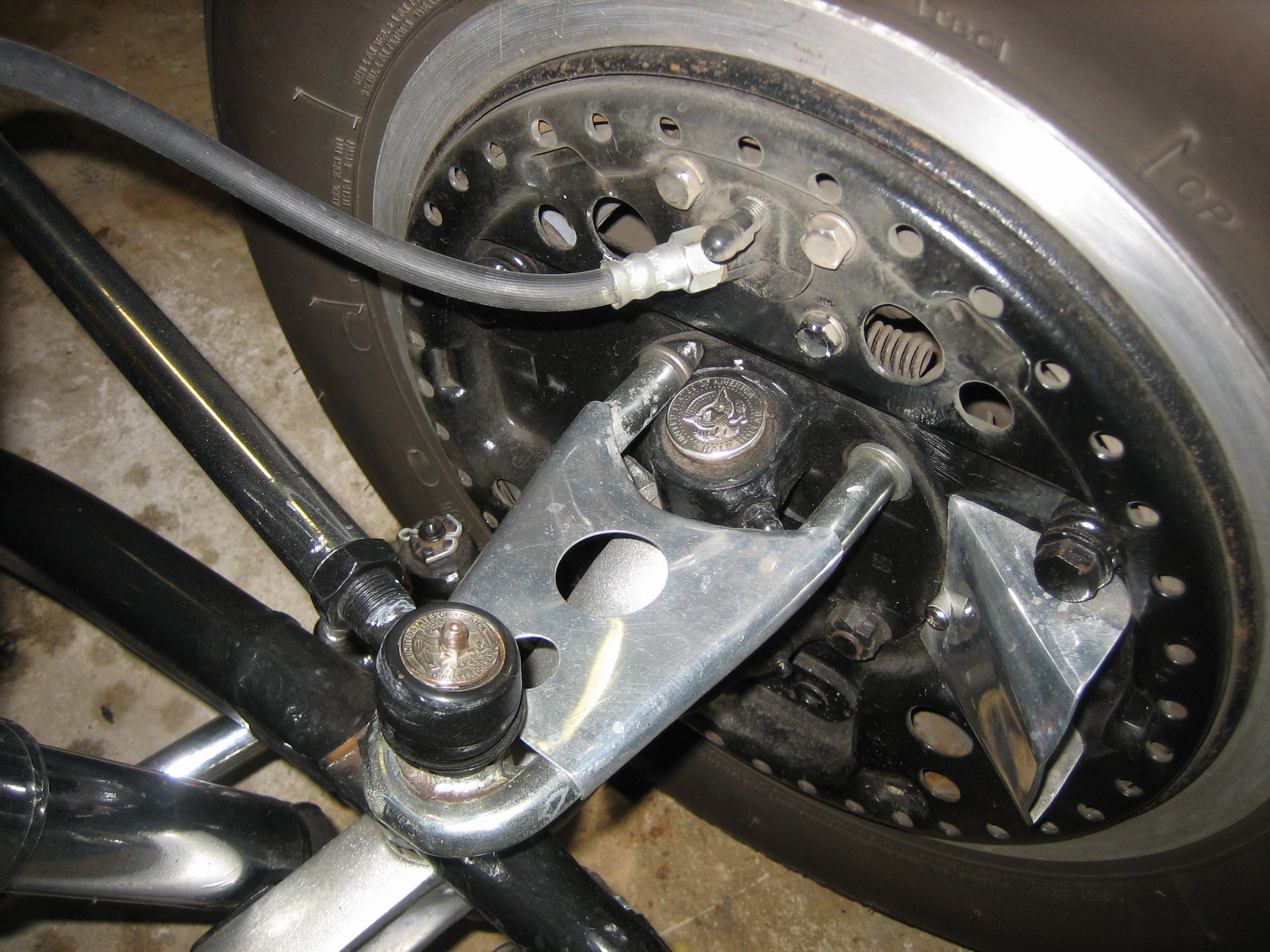

    Little things can be missed ,but I really like them,I added a lot of them in the early 1960s too my Sr High School hotrod{ I still have*} Stuff I thought of as I could.:)
    So Even now days I look a bit extra for that type of stuff on others cars as well.:cool:
    I guess ,some day I should count,what I call details? My be around a 100 or so.:D
    My front wheel pic has a few, like the 25cent caps on all rod ends an JFK 50 cent kingpin caps, coins I put in place to be shiny spots,the homemade brake scoops n shiny bolts , drilled holes> It would of helped if I cleaned things more often as well,before clicking pic too o_O Opsss.

    FYI: They are called a Clam Shell Vent (Ventilator). They are available in stainless or chromed brass and come in several sizes. They are typically used in boats so you may be able to find them at your local marina or on-line.

    Having sailed in various size sailboats since high school, those vent covers always looked good on anything. The shape just looks as if a “rocketeer” had a hand in designing it/them. On the boats with motors, small or large, the shapes were used as an air flow to get the aroma of the diesel or V8 motor out of the motor compartment. No one wants or needs excess gasoline/diesel aroma to stay locked in an engine compartment below decks.
    So, from these little vents
    to larger louvered vents
    upload_2025-8-2_4-27-30.png these are for vents that allow sealed motor areas to vent to the outside open air areas on boats.
    upload_2025-8-2_4-30-59.png replaced with upload_2025-8-2_4-45-40.png a single stainless steel louvered plate.
    Jnaki
    We have used all of the above to replace ones that need replacing. But, the one thing they all had in common was that there was no such thing as sealing fumes in a hole. Unless, one drilled a hole and put in a grommet with a hose. The motor compartment was totally sealed from the interior and these were the vents that were in place to allow those fumes to escape outside of the hull.
    They all were used as engine fumes outlet to the outside of the hull facing downward to not let water from rain or hosing it off to clean after sailing for a day.
    If one uses a wires or hose to go inside one of the triangle caps, the hole in the firewall has to have a sealed grommet or else you will get fumes coming into the interior from the motor compartment. So, beware of the additional safety issues. YRMV

    Good point jnaki. Yeah, these went over grommeted holes.

    And... sometimes, like in your case, stuff "needs" to be dulled down to fit in. Otherwise, if you're like me, you'll start polishing everything else to match and then you have a very different project. I like how you kept the new parts in line with the vibe.
    However, I also like that all your screws aren't clocked (some are some aren't). I haven't seen a period car, survivor, etc., yet that had clocked screws.... and that's some of the weird stuff I look for.
