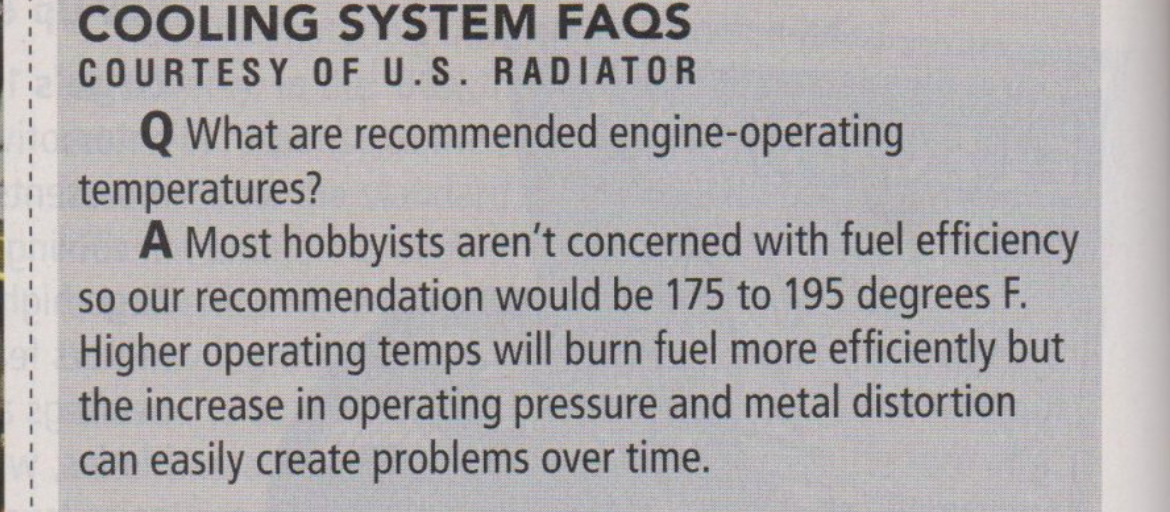

    Toured Brice Thomas’s facility. Know the owner
    Very cool process.
    I like fuel efficiency.
    Excessive wear over 195?
    Hmmm. I’m not buying that at face value.
    Newer cars far out mile our older ones and run in that 210-215 range.
    For some crazy reason the vette scientists like their cars running around 220+
    But it’s kinda like oil
    believe whatever science ya like. Just use oil
    and use a radiator on non air cooled rides.

    Never trust the science. Buy what the internet says is good. Never fails. o_O

    Agreed.....with that in mind, here is something else from the internet. :D
    At what temperature does oil break down?
    "No, there is no "exact" temp where it degrades. For example, if "250" is the answer, that does not mean the oil is perfectly fine with zero degradation at 249, but at 251 its falling apart. Its somewhat of a linear process. The degradation process starts low, and ramps up into very high temps. A quick search tells us:
    • Conventional motor oil: Can withstand temperatures up to 250°F, but starts to break down at 275°F
    • Petroleum-based engine oil: Begins to oxidize, or break down, at around 240°F
    • Full synthetic oils: Can handle temperatures above 300°F, and some can withstand temperatures as high as 700°
    Time is a big factor. Running the oil at 275 for 5 minutes is nearly nothing. Running it at 275 for an hour is very different."
    While I'm not saying the above info is absolutely correct, it is logical that as oil temp rises that it does affect the oils ability to lubricate and cool the moving parts. The question then is "at what temp does my oil of choice" begin to have issues. An engines oil temp is normally higher than its coolant temp during normal operation. Obviously there is an operating range rather than just one temp thats acceptable. I prefer to try to stay at the lower end of that range and have more of a "cushion" so to speak. I honestly can say that I don't remember ever seeing someone have a problem much less lose an engine from operating at 175/195 degrees. Maybe a little less efficient, maybe a little more wear or maybe not, but never a catastropic failure caused by that temp range. So, I'm good with that........:)
