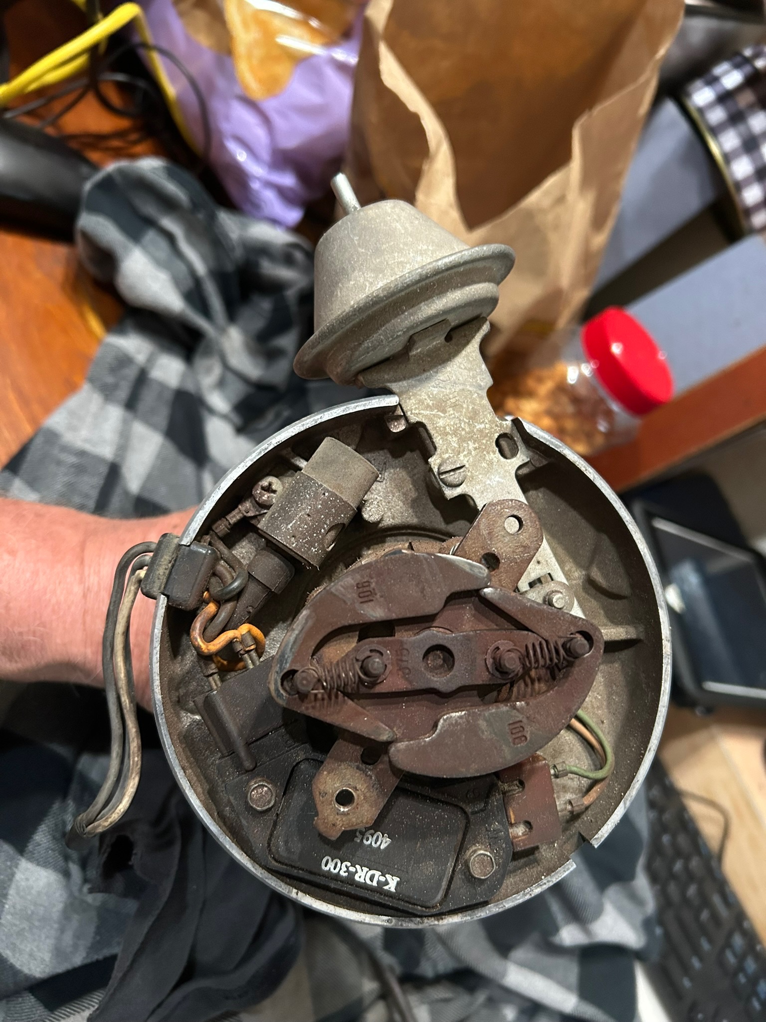

    Have you tried flipping the weights in the opposite direction just to see what happens ? I know this is frustrating for you, but it might be worth trying if nothing else is working. If a distributor is turning clockwise, the centrifugal force should be in the same direction no matter what type of distributor is in place. Good Luck with it.

    Looking at this image...
    Those weights don't look like they are properly parked. Note the center plates shape, it has reliefs for the weight fingers.
    That would set a preloaded mech advance, this also limits available mech advance, and also why there is no change in mech advance at lower rpms.
    The spring studs are usually more inline as well, at rest.
    Flip the weights like Moriarty posted and see if the weights park closer to the shaft.

    Read the rest of the thread. I'm done commenting on that.

    Is this what you're working on?
    Turn the weights around.
    deathrowdave and twenty8 like this.

    No, Gene. All SBC's and subject big block buicks rotate clockwise. On GM clockwise rotation points distributors, the big side of the weight is after the pin (in direction of rotation). On GM clockwise rotation HEI distributors, the big side of the weight is before the pin (in direction of rotation).
    That's clearly not well understood, as evidenced by the MANY replies on this thread that think they're backwards.

    It would do you well to play with the weights on an HEI. That's what they look like fully retracted. There is no mechanical advance acting as shown in the photo, and the weights are fully nested against each other (rest position).

    This sure had me looking, so I found a GM HEI setting around and the weights are as you showed. Found a Pontiac points distributor and it had the weights like yours. Guess there is a difference between a points and a HEI as to how the weights are.

  13. Your mechanical advance weights seem to have a very different shape, compared to the various photos of sbc hei distributors.
    Are your weights, GM factory for Buick 455?

    Here's what I found:
    • With the lightest springs in the MSD kit and the factory weights, the mechanical advance starts at about 1,000 rpm on my setup. It's all in about 2,500. The springs were my issue.
    • I tried light springs out of a moroso kit and they came in a little later.
    • It didn't like the light msd weights.
    • The factory 438 center cam with the 053 weights only gives about 15 degrees of advance. I might need to see if I have any other center cams to try for a little more total mechanical advance.
    • For the 11+ replies that said the weights are on backwards, and a few that said they're not at the correct position at rest, that's not correct for an HEI.
    • After getting the mechanical advance working, I tried my vacuum advance on both ported and manifold vacuum. It sounded and smelled happier at idle with it on ported, so that's where I put it.
    • A test drive showed me I still have a little bit of carb tuning to do, but it's 90% better than it was there are 3 150+ foot tire strips on a back road nearby that tell me I'm getting there.
    For whatever reason, this distributor wants really light springs. With a different center cam it might want to be all-in a little later, time will tell. As is there's no pinging through the rpm range so it's much better than before.
