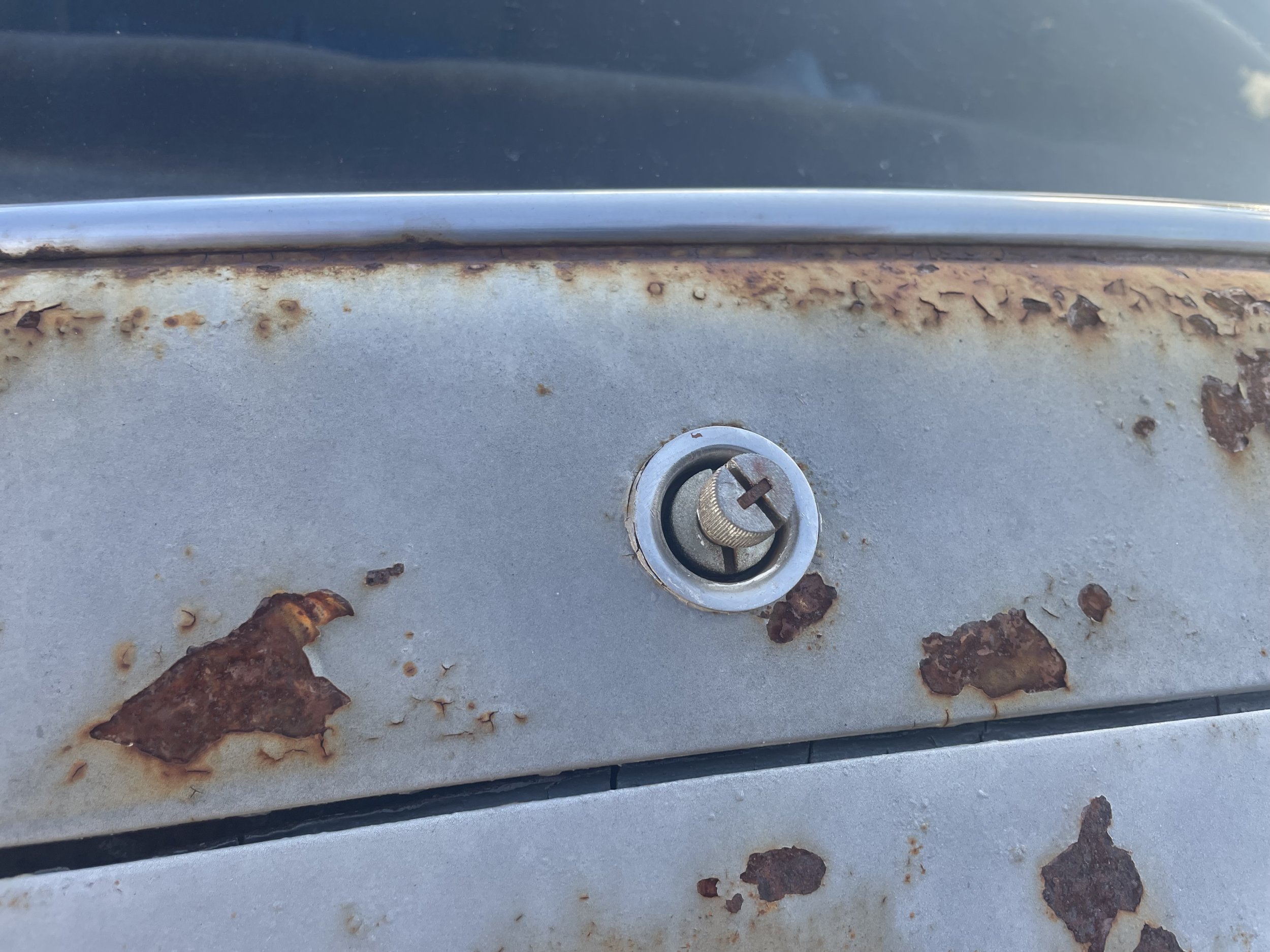

  4. Car has a tissue holder, gm spot light, driving lights and a reverse light.
    Didn’t realize these cars had a rear wiper. Was that standard?

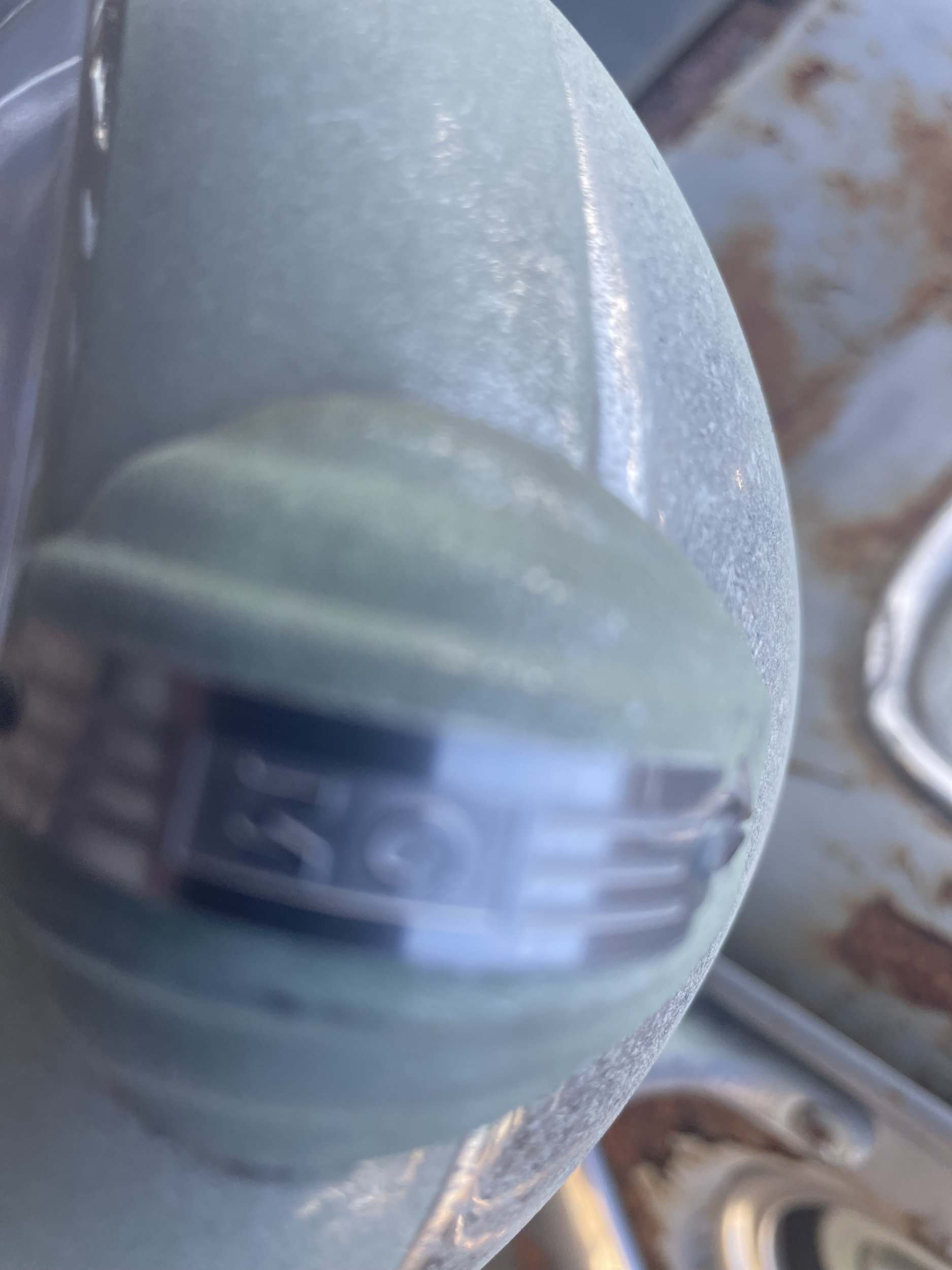

    A neat project for someone would be to mould some resin around that steering wheel.
    porkshop, Okie Pete, Sharpone and 4 others like this.

    Yeah the rear wiper is a neat option...what does the switch look like? That might give a clue...it seems like it belongs...must have been a short blade.
  15. Not sure yet.
    I’ll get a pic
