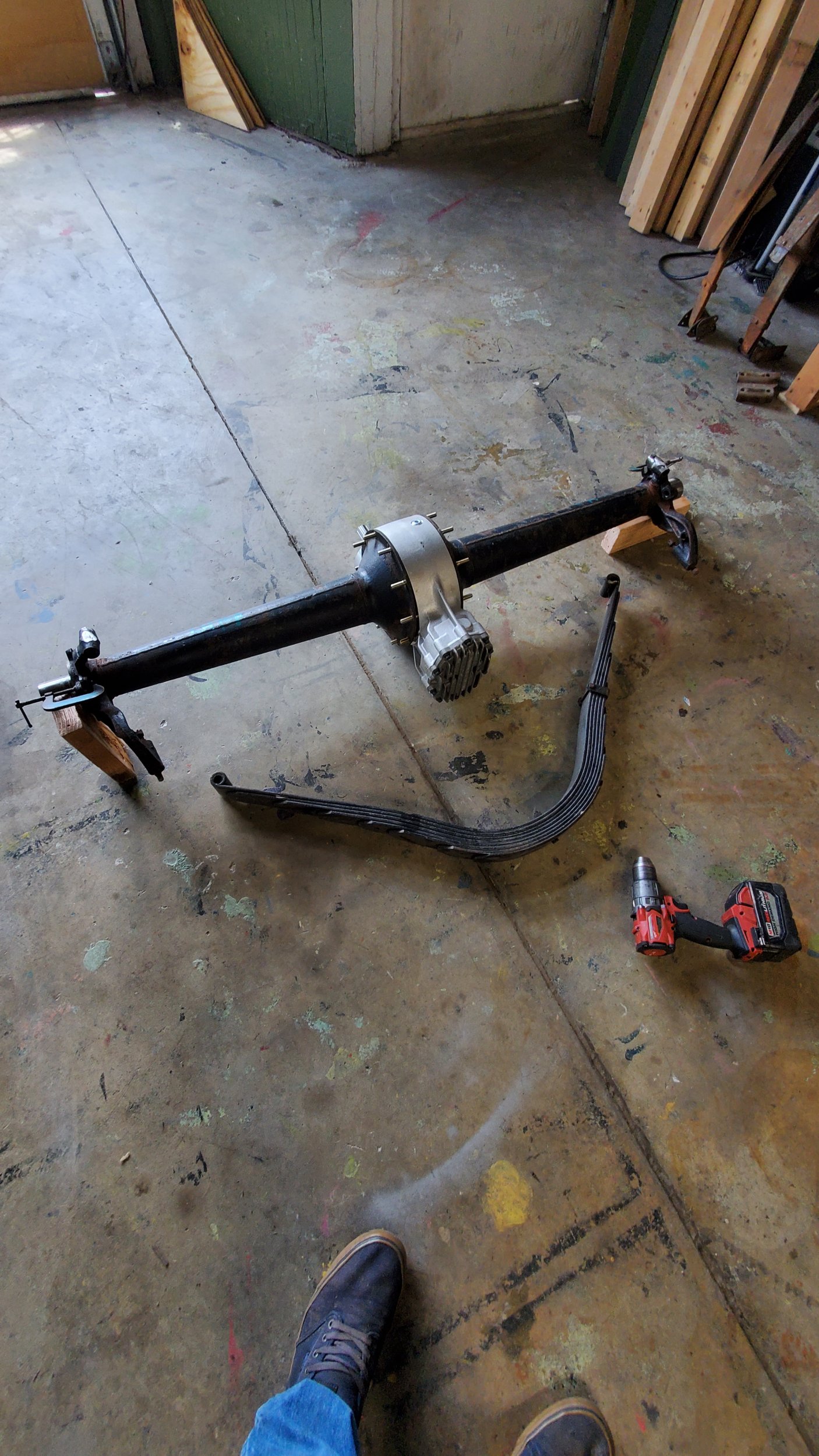

    Not much progress this weekend, moved the brake M/C hole over on the F1 cross member, had to take my life in my hands and use a 20250713_134739.jpg 20250713_142506.jpg 20250713_142714.jpg hand drill to cut the large hole my rota broach lost all its teeth in the process. Also broke down and steam cleaned the banjo rear end in preparation to assemble the Q/C. Ordered a kings ransom worth of bearings seals and races hoping to get it together as parts arrive. Not super happy with how long the studs for the axle bells are, bottomed a few out and with nut and washer they still have close to 3/8" stick out.

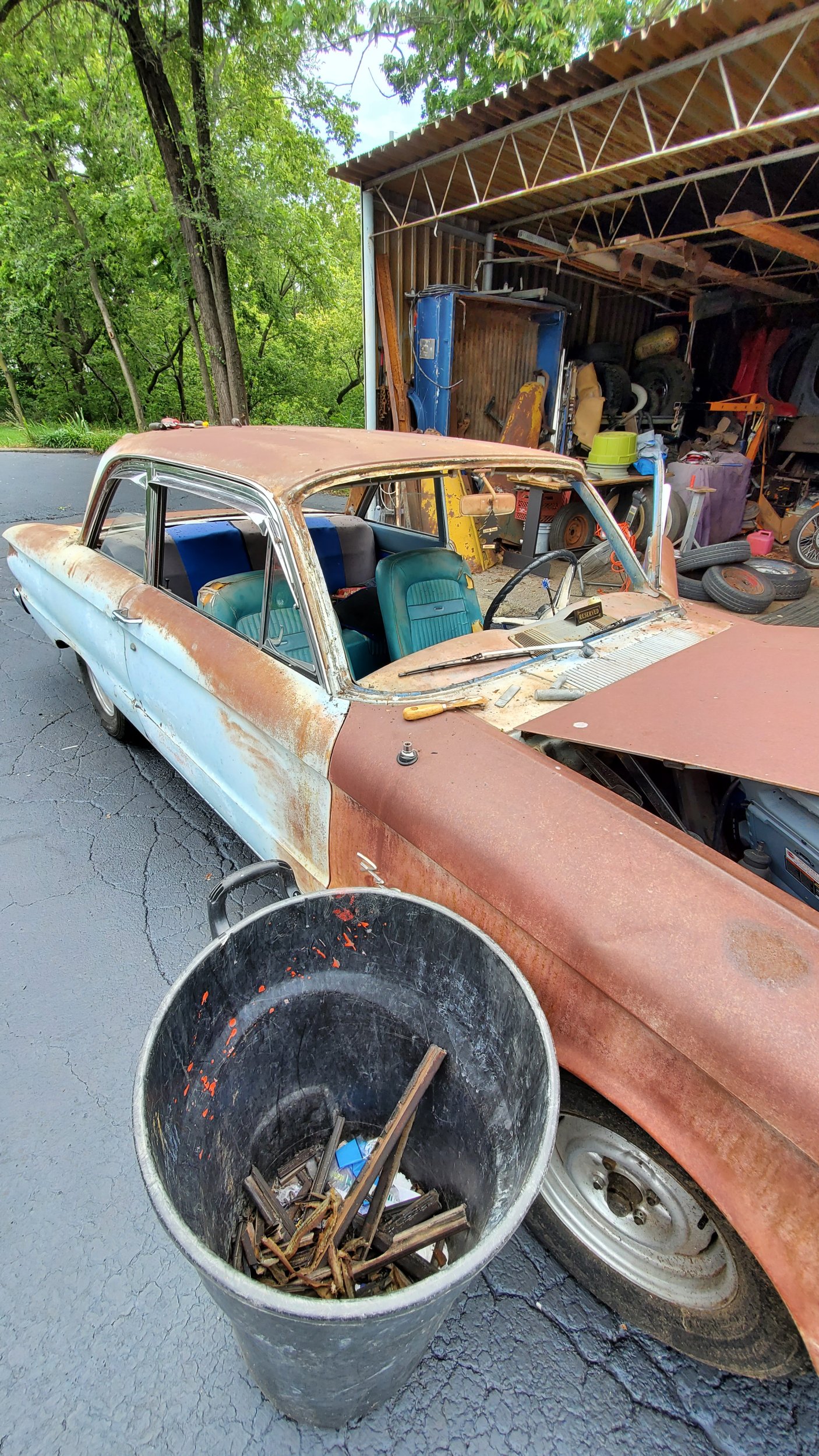

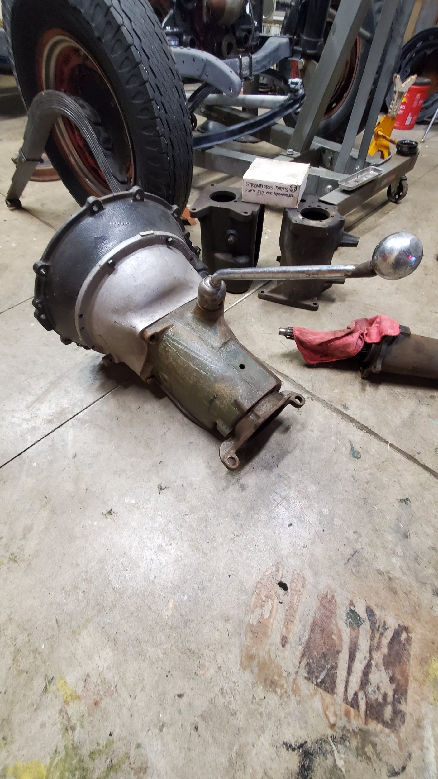

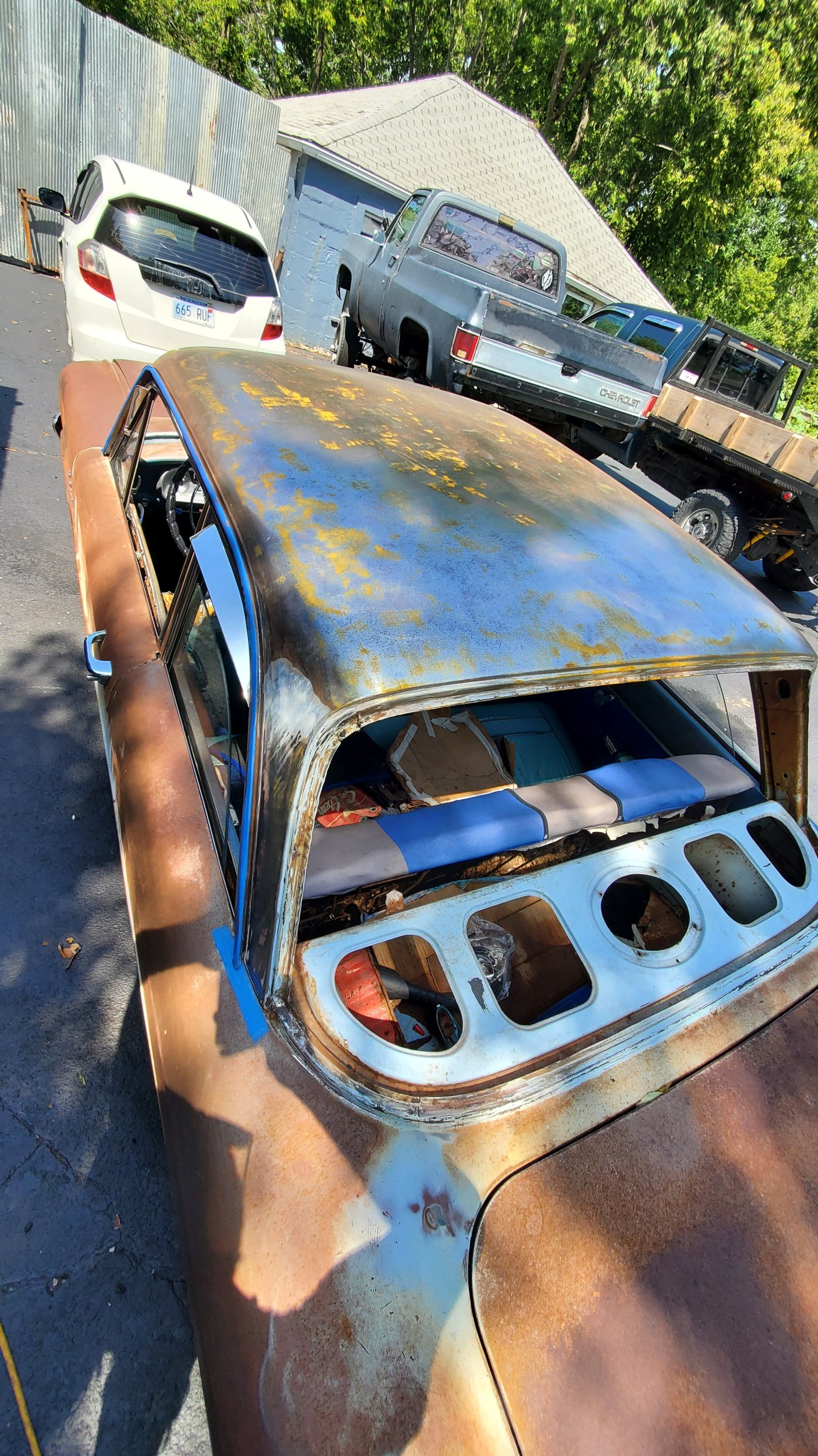

    20250725_175123.jpg 20250722_113836.jpg 20250720_122036.jpg Not much progress this past week or two. Bearings and seals have been arriving for the rear end, seems like everyone is sold out so I had to go through a few different suppliers. Going to get my trans case and gears boiled and assembled soon. While ive been waiting I spent some time working on my falcon pulled the glass knocked the roof down to bare metal and epoxy primed it.

    Cool project, love early Falcons too.
    Had a quick read back but can't see what that gearbox is? Thanks for the updates
  4. chlsnk
    Joined: Dec 11, 2008
    Posts: 134
    chlsnk
    from Kansas
    37' Cadillac/lasalle.

    Finally something that looks like progress tonight. Bearings races and seals installed onto the bells, webbing clearanced for ring gear bolts. Tommorow evening I'm going to get the carrier cleaned up and ready to reassemble
    Pressed in new shackle bushings; hangers and spring. I've had so much trouble with this in the past. The difference has been my method of removal, instead of running a hacksaw through the bushing I cut down a Sawzall blade to fit though the old bushing. This made quick work cutting a relief that let the old bushing come right out with a cold chisel. On the hunt for a rear shackle after inspection it has a pretty good waist worn into it.Before it got dark I was able to get another coat of 2k primer on the falcon roof hoping to block out the tiger stripes and get some single stage white shot this week if we get a break from the 70% humidity.

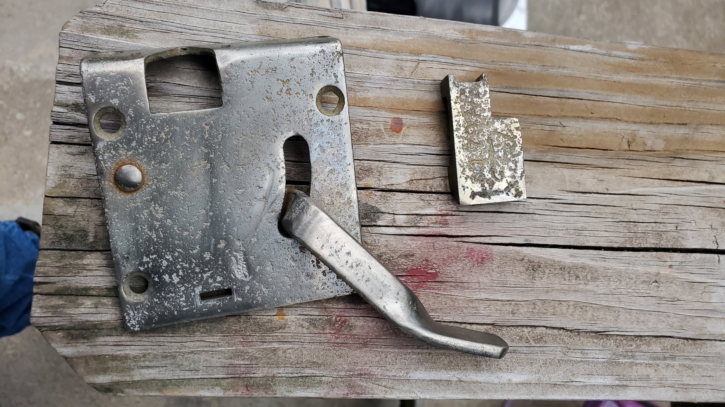

    20250804_180930.jpg 20250804_183623.jpg Not much progress recently but I am now a firm believer in evaporust. Dunked my door latches in a jar of the stuff and they came out beautifully in the white. Scrubbed them down pulled them apart completely for round 2 of clean up and re assembly. Pleased with how simple they are inside, looks like a hard ware store spring with a 1/4" ID will have them back in useable shape. Not sure how I want to treat them before putting them back together, maybe a coat of primer and grease the sliding latch?

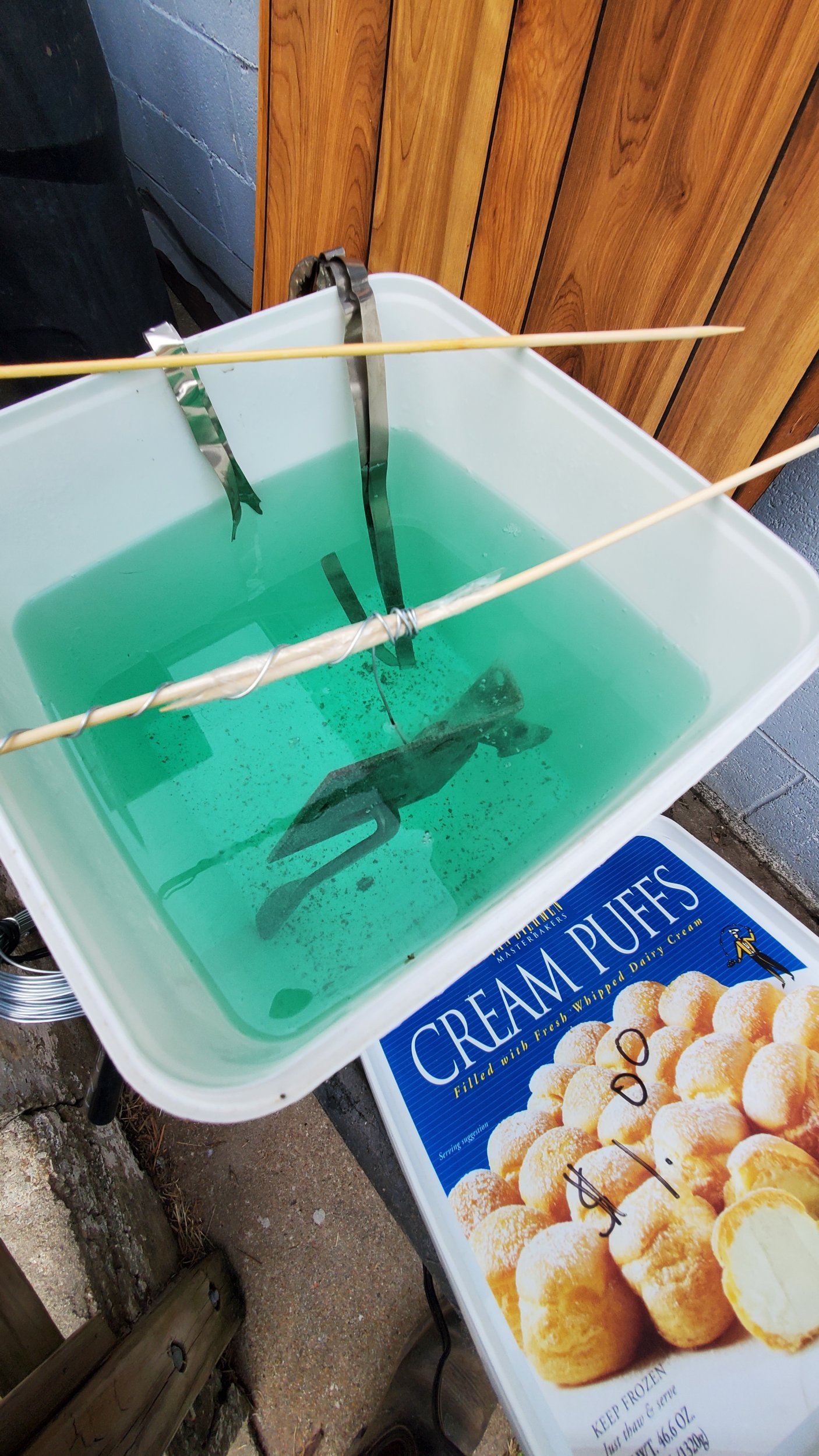

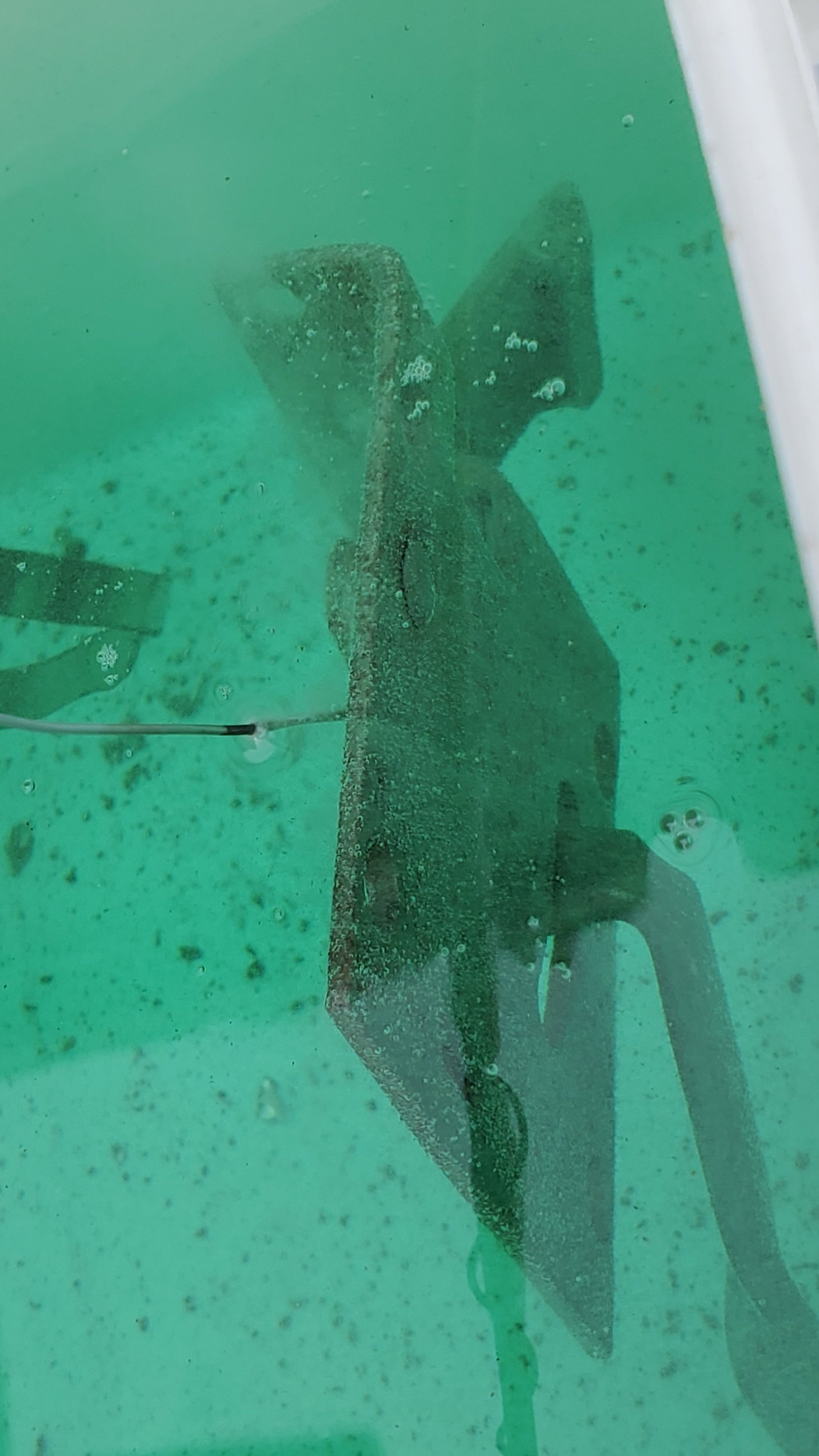

    Pulled the door locks apart and nickle plated them, I've never plated anything larger than nuts bolts and small gun parts so this was all a learning experience but I'm pleased with how it turned out. 20250810_190133.jpg 20250810_190147.jpg 20250810_193602.jpg

  25. Outback
    Joined: Mar 4, 2005
    Posts: 3,227
    Outback
    from NE Vic
    I love the finish, perfect! Electrolysis I assume?
    chlsnk and 26 T Ford RPU like this.
  26. chlsnk
    Posts: 134
    chlsnk
    from Kansas
    Yes its the easiest way, pretty safe and simple. Low amperage/low voltage takes some time but good results can be achieved.
