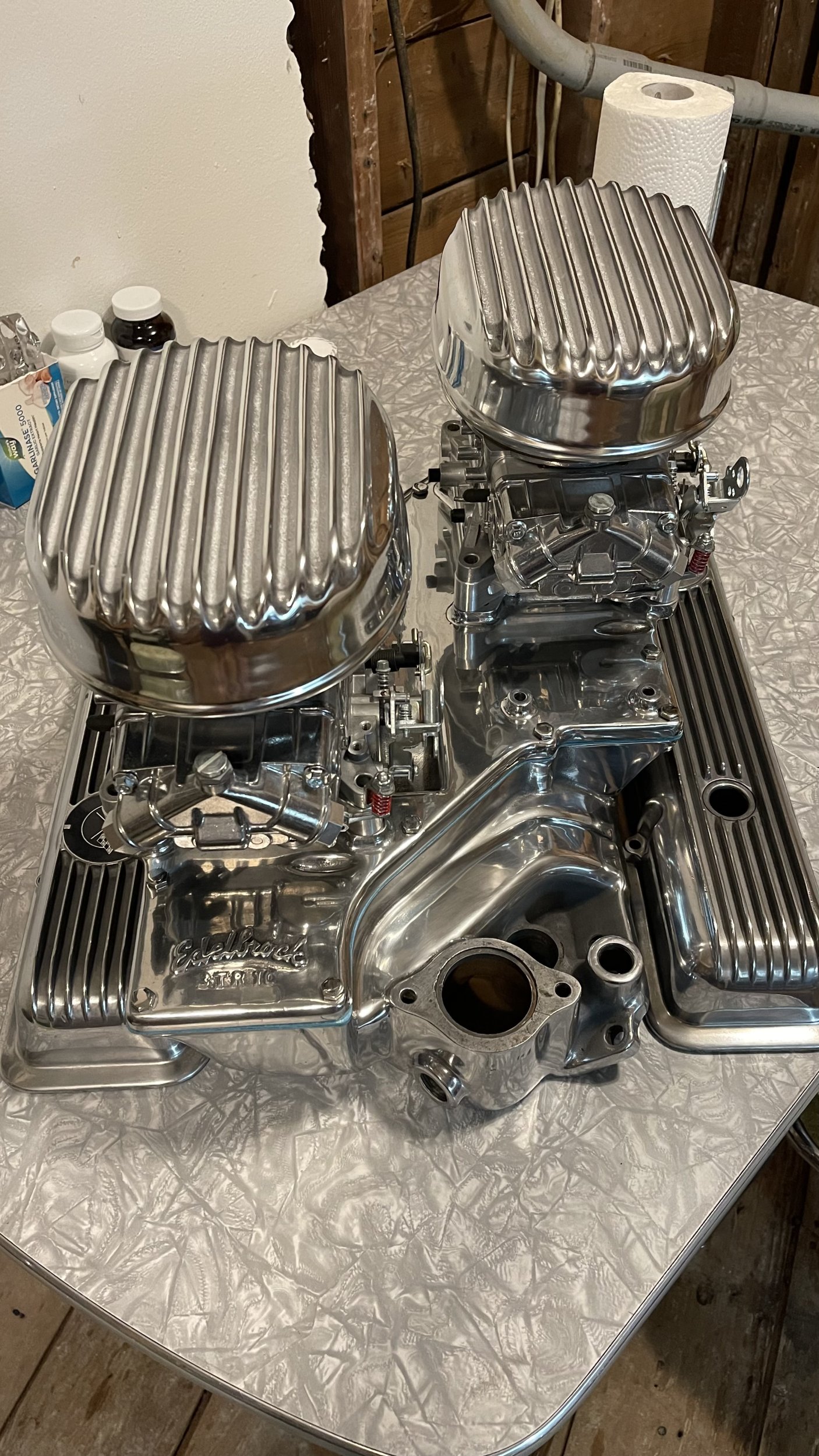

    Not a lot of progress to report- to condense what I’ve been scheming up lately. I ended up with a total of 3 (4 if you count the one in the daily) 880 roller cam Vortec head small blocks, all in excellent condition. As such, I have accumulated a plethora of possibilities for engine builds. After a lot of back and forth mental anguish, I’ve decided to leave the daily stock and look for something else later down the road to replace it, likely a square body pickup. None of that matters to you guys, just letting you know I’ve been sorting through the intakes, carbs, heads, headers, measuring the blocks, planning, scheming, spending, etc.
    I’ve also kept my parts collecting under wraps as I tend to change my mind a lot after I mock things up, and it takes forever to find this stuff in general, but without further ado, a teaser of what’s to come for the Belly Button:
    brEad, Uncle Ronn, loudbang and 7 others like this.

    Sheesh that’s shiny! Two piece cross ram? I can dig it!

    I've wanted one for a LONG time. After watching the Engine Masters episode where they tested one a year or so back, I started looking again and managed to find this one shortly thereafter. I already had the carbs from a tunnel ram idea that wasn't meant to be, so this was a logical decision lol.
    brEad, porkshop, Uncle Ronn and 5 others like this.

    Had one of those intakes with the single 4 barrel lid back in the 70s for the dirt cars. Not great off the corners, but the top end rpms were really good! We couldn't run dual 4 barrels. The original Edelbrock Tarantula and Torquer manifolds were better off the corners, but gave up 3/4 of the way down the chutes. Look at Lebanon Valley Speedway on Google maps and you can see why...

    RodStRace
    Tim, I've said it before, but you seem to keep at it until you are happy. I like the new parts, but I'm not getting attached, 'cause you might just swap out again! :D
    If I were to dream of SBC inlets that were limited to carbs, I think it would be these (vertical only!)

    Oooh I agree! Fantabulous setup! A GMC 6-71 and 2 4s would be a little bit much, but as they say, if some is good, more is better, and too much is just enough!
