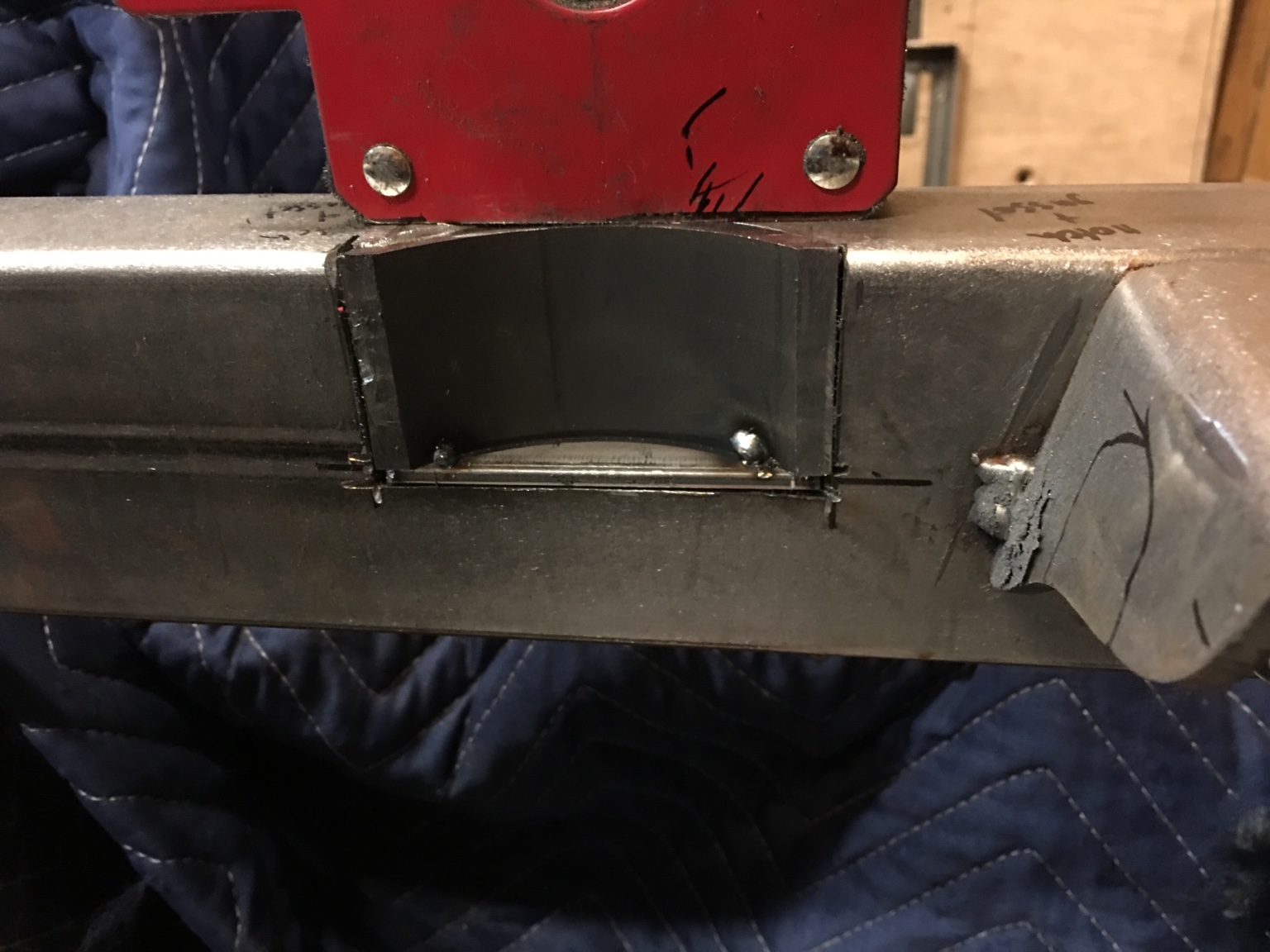

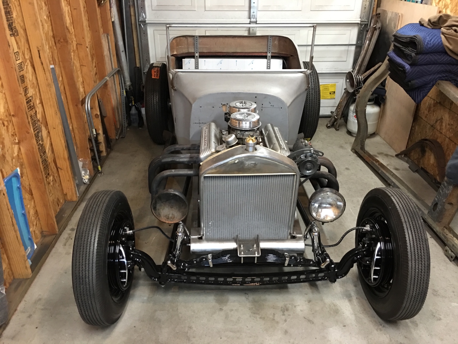

  4. Tim_with_a_T
    Joined: Apr 30, 2011
    Posts: 1,656
    Tim_with_a_T

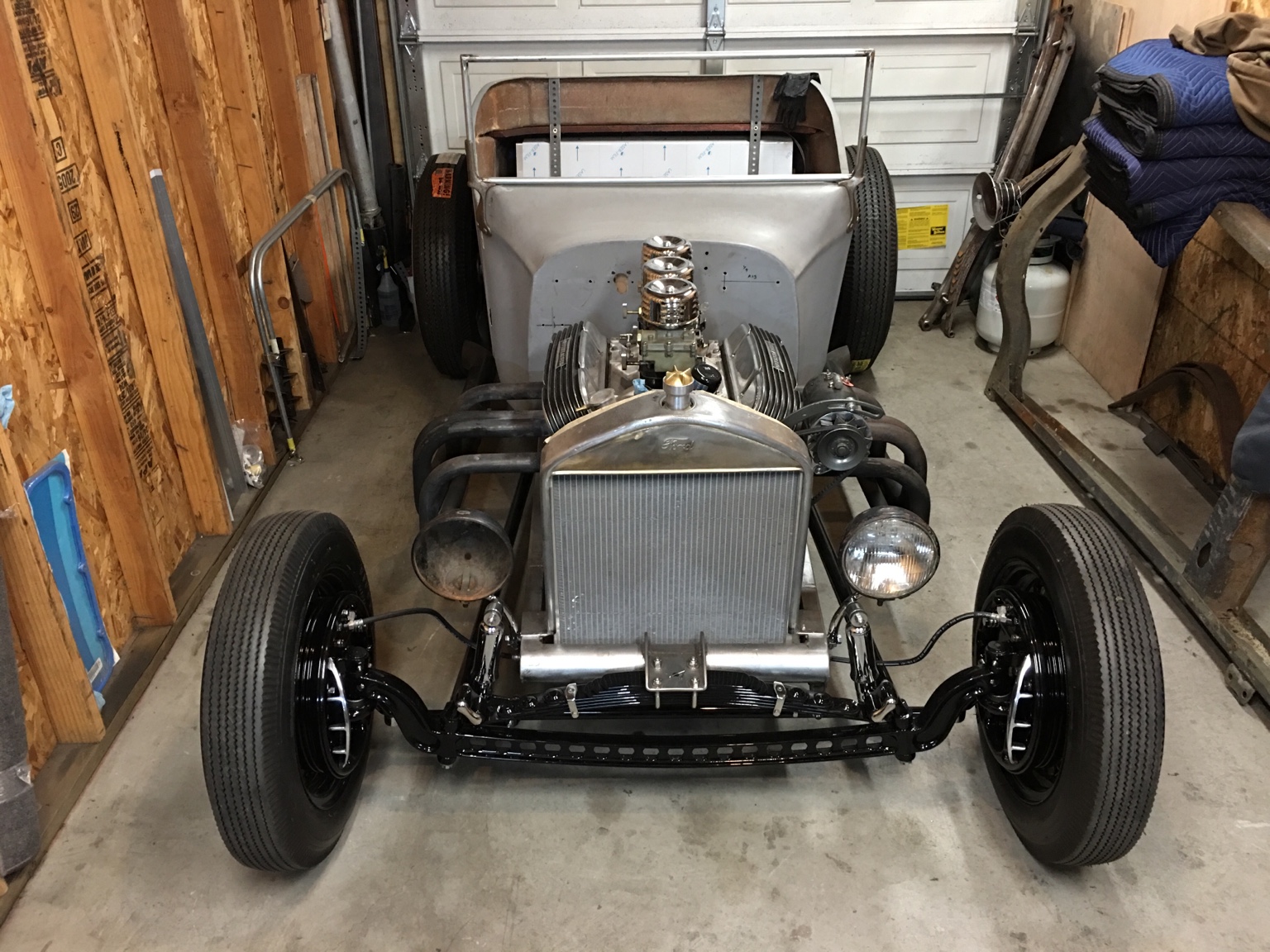

    I figured I should post some teaser shots so you guys know I'm not holding out on you, and maybe it will help motivate me...
    Trying to decide if I like the tri power...
    Or the dual quads...
    To me the dual quads really set it off. And.... the 'Vette intake solved my complex upper radiator hose situation.

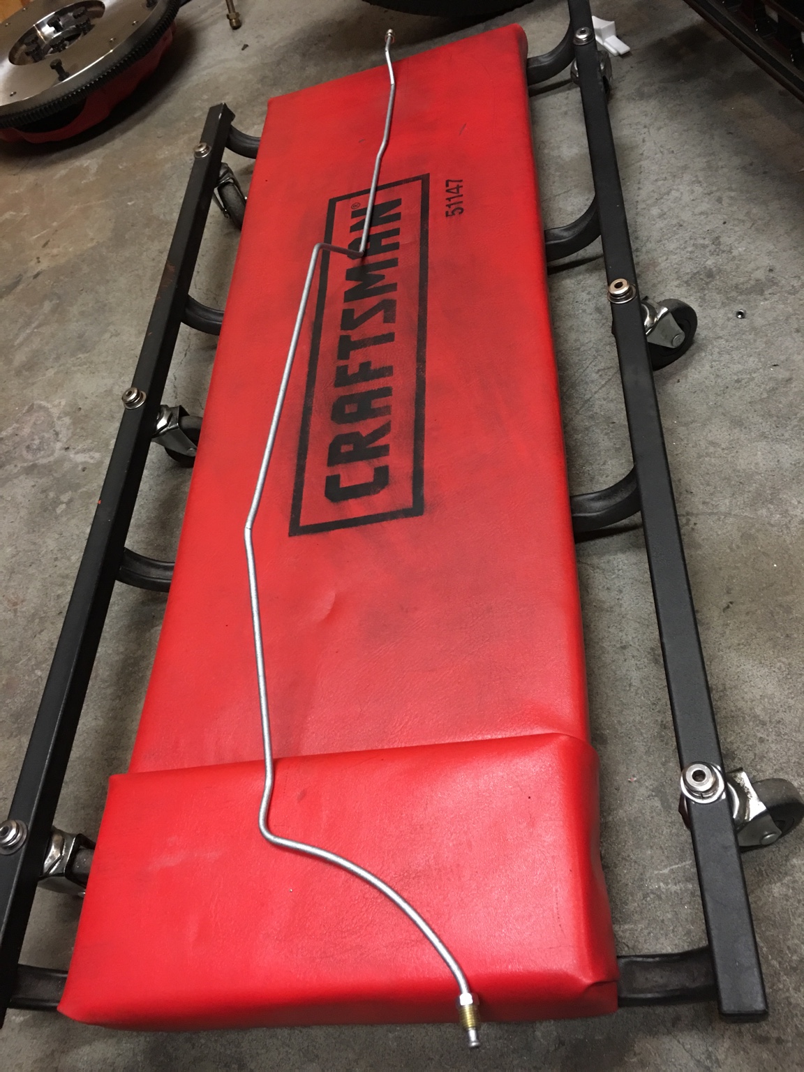

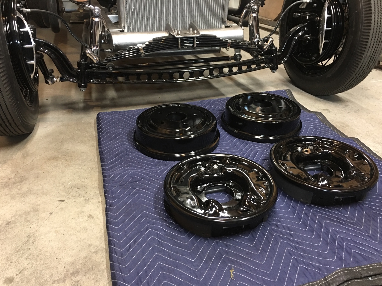

  5. Tim_with_a_T
    Posts: 1,656
    Tim_with_a_T

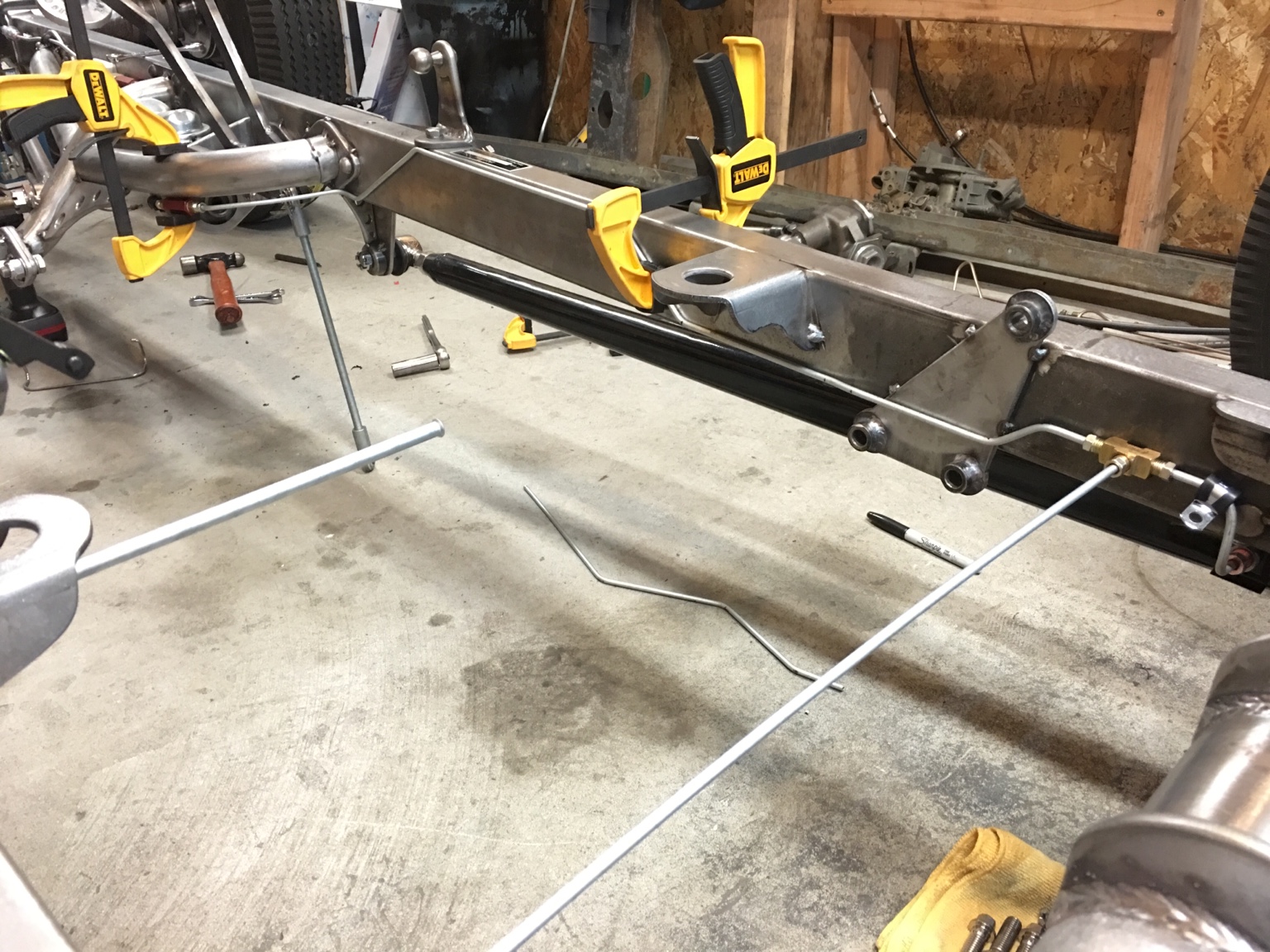

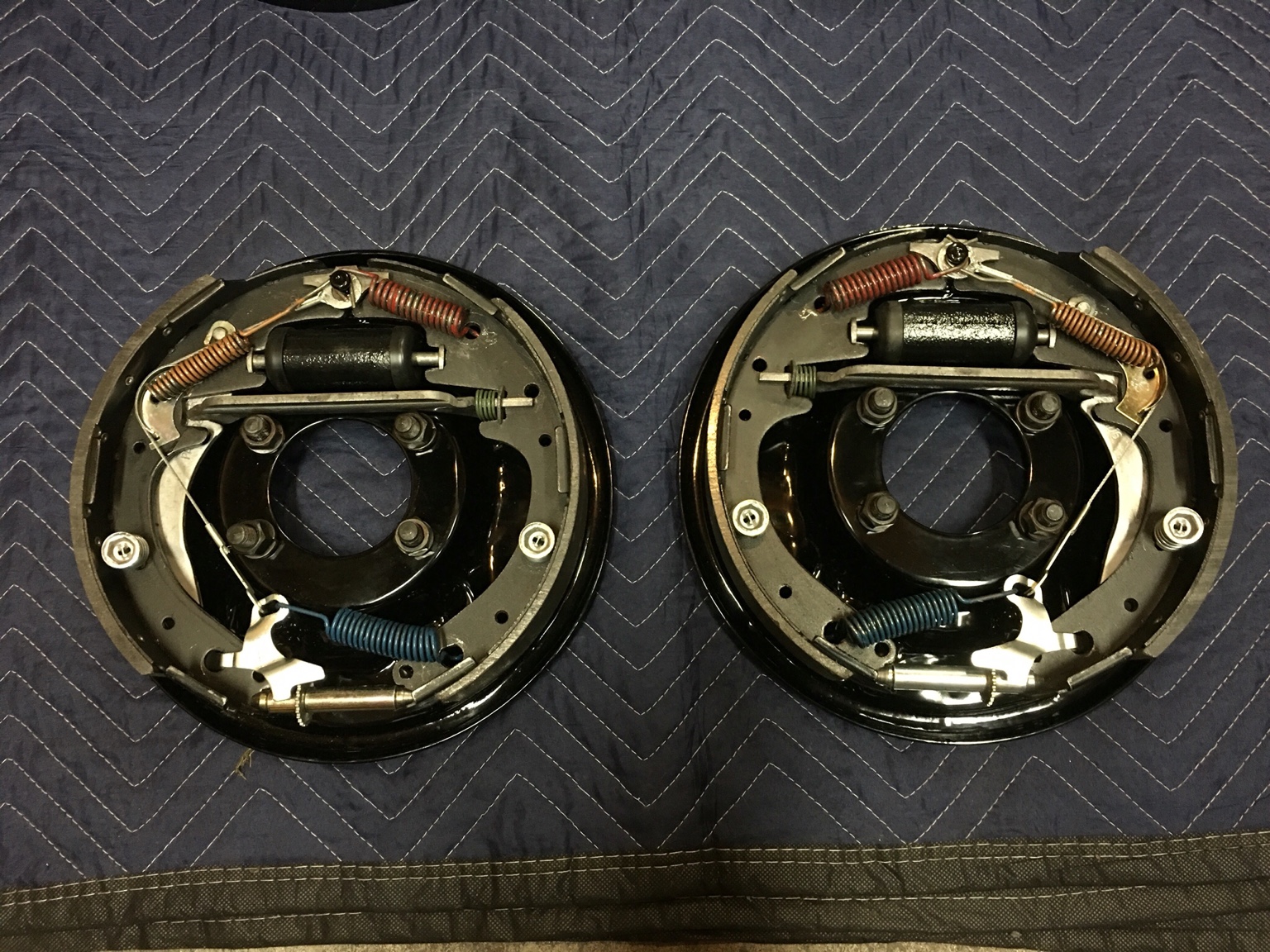

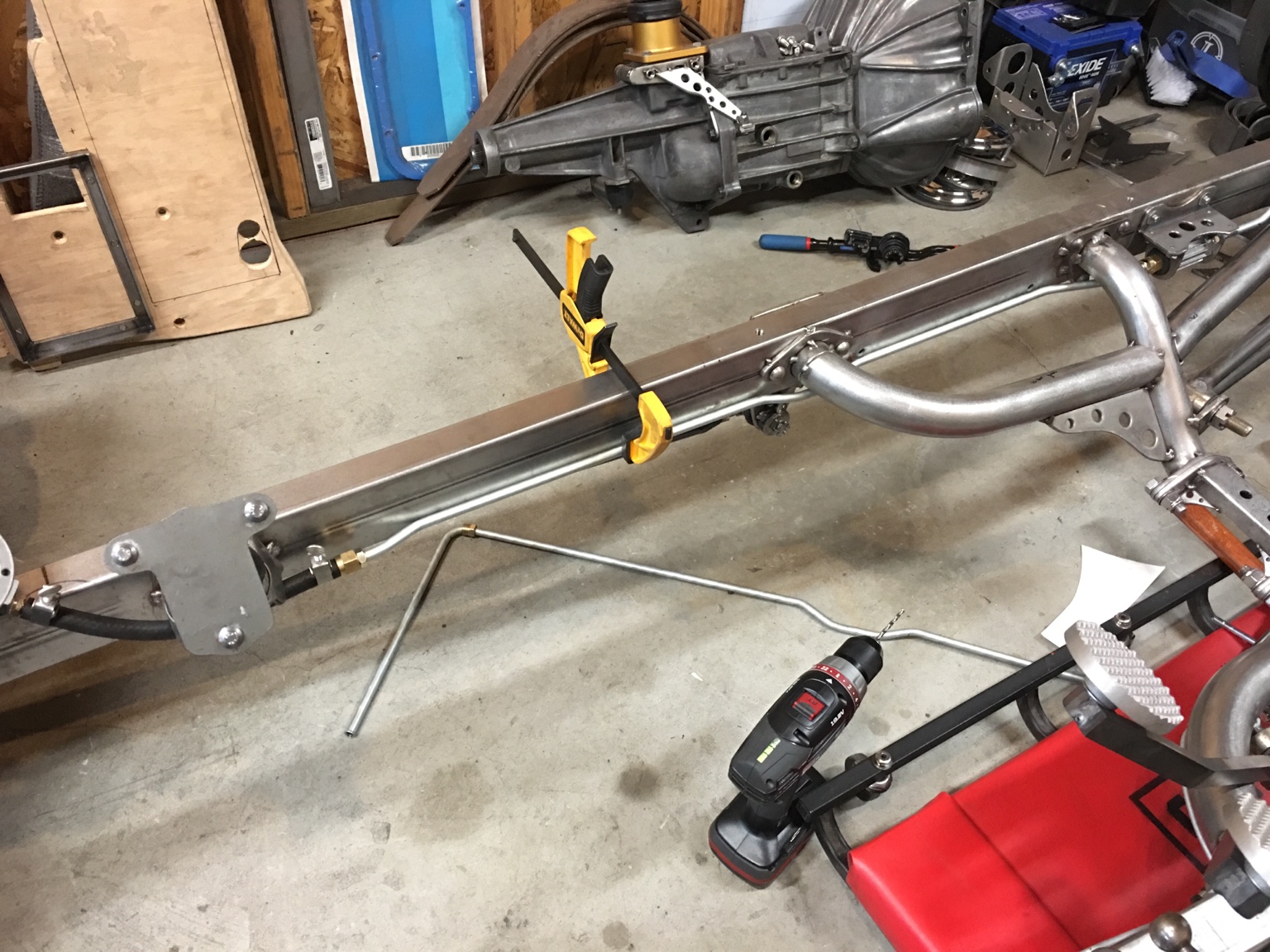

    So you've seen the front brakes completed- here are the rears.
    And here are a few shots of the brake and fuel lines.
    AHotRod, '52 F-3, T-roaster and 6 others like this.

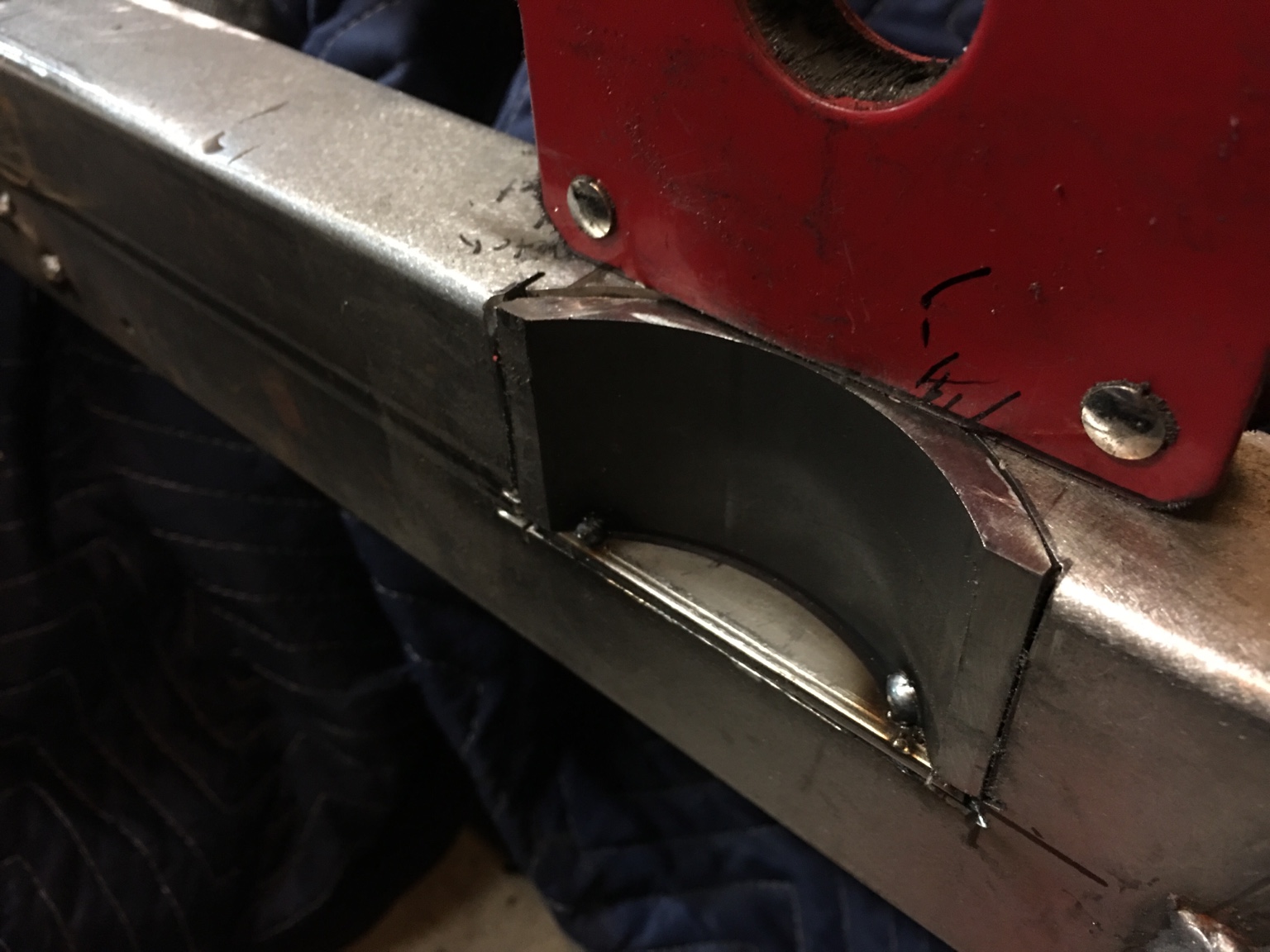

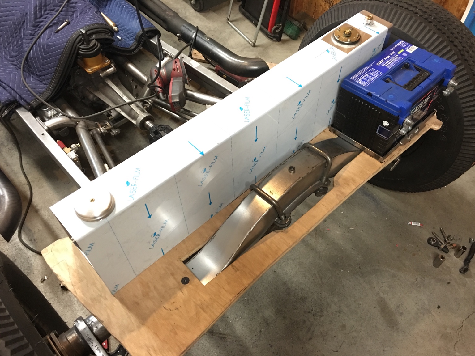

    This is the tray that will be the floor for the pickup bed, with the battery tray and fuel tank mocked up.

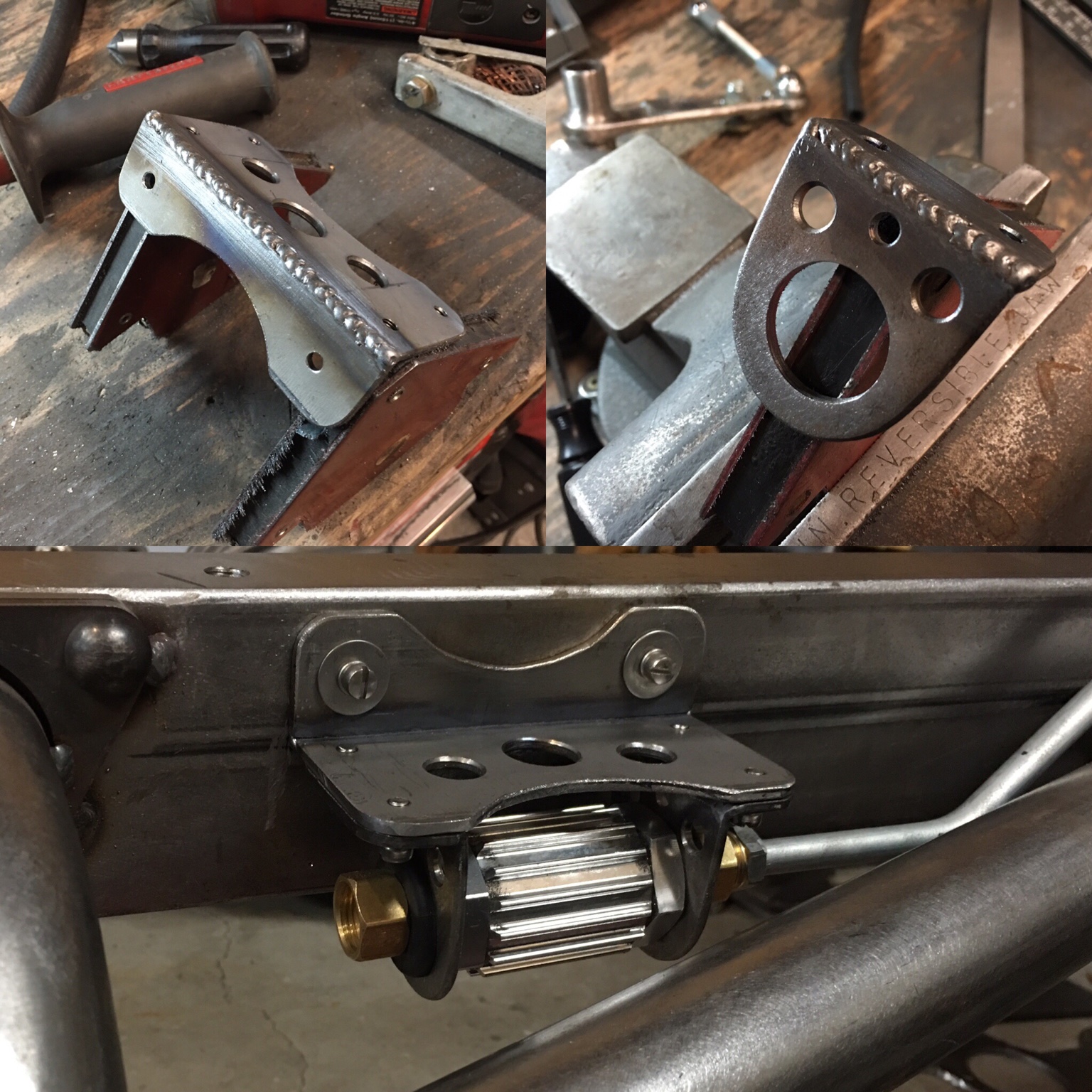

    Here is a fuel filter bracket I made that I thought turned out pretty decent.
    And here is some pics of the notch for the fuel pump.

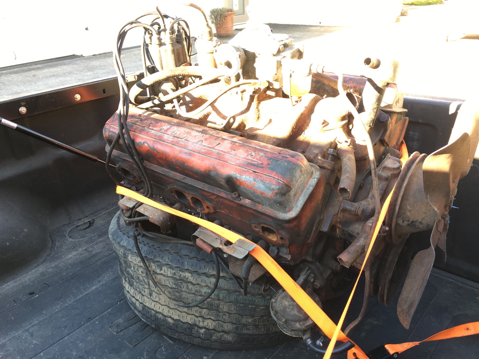

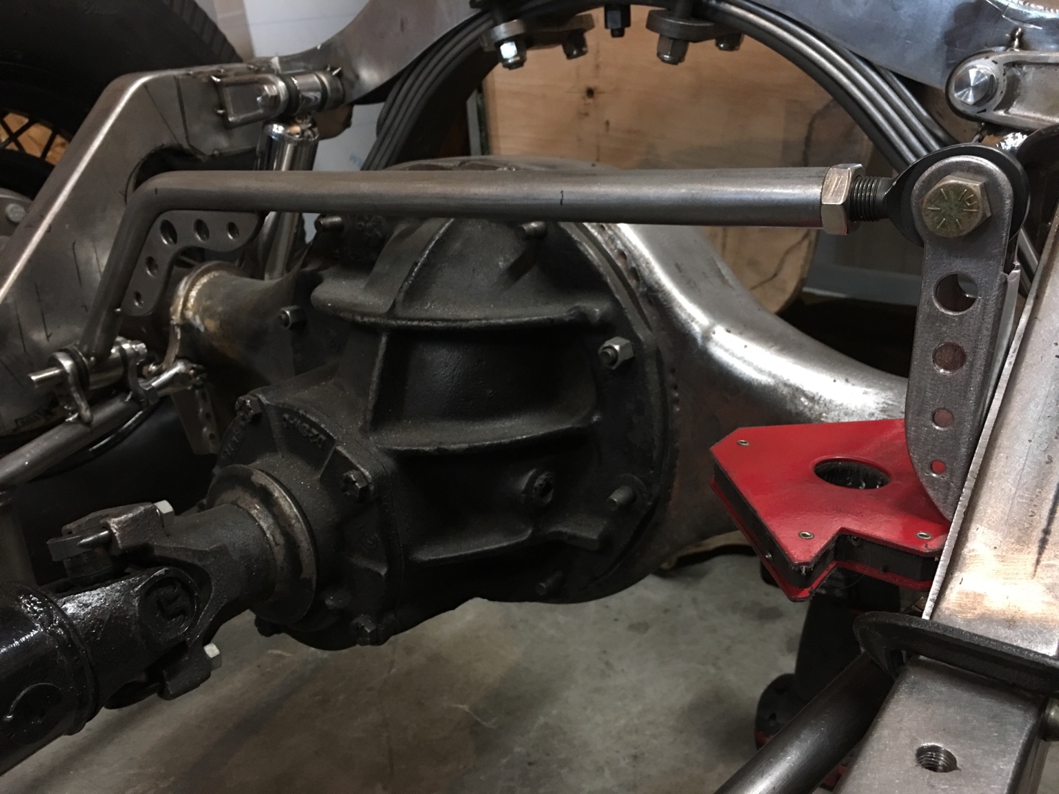

  7. Tim_with_a_T
    Posts: 1,656
    Tim_with_a_T

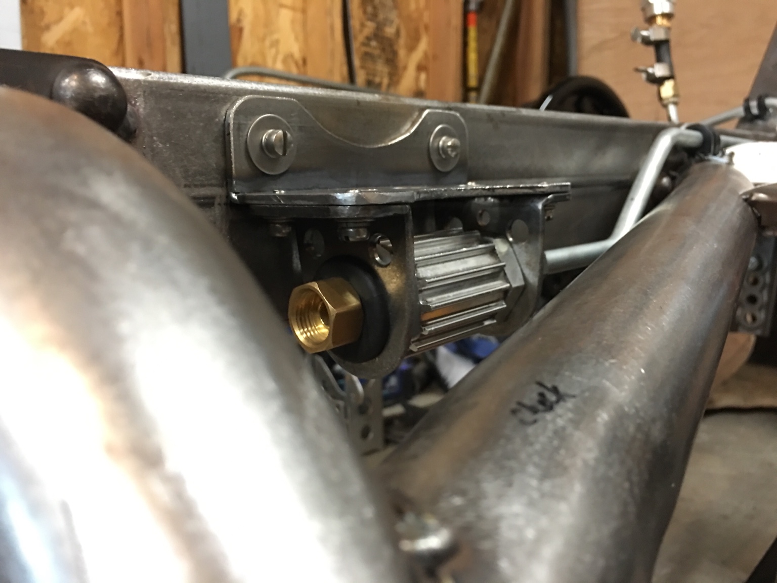

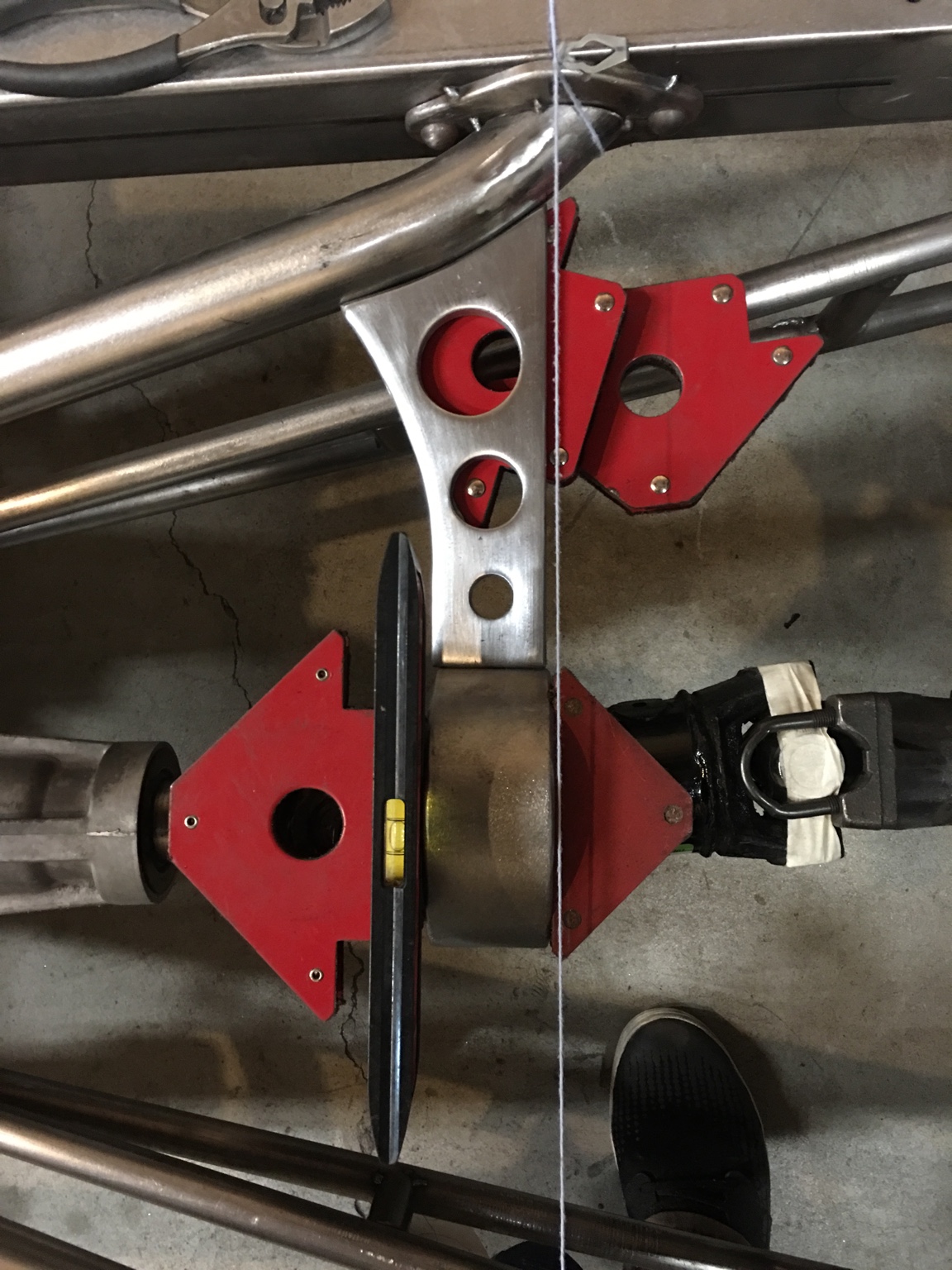

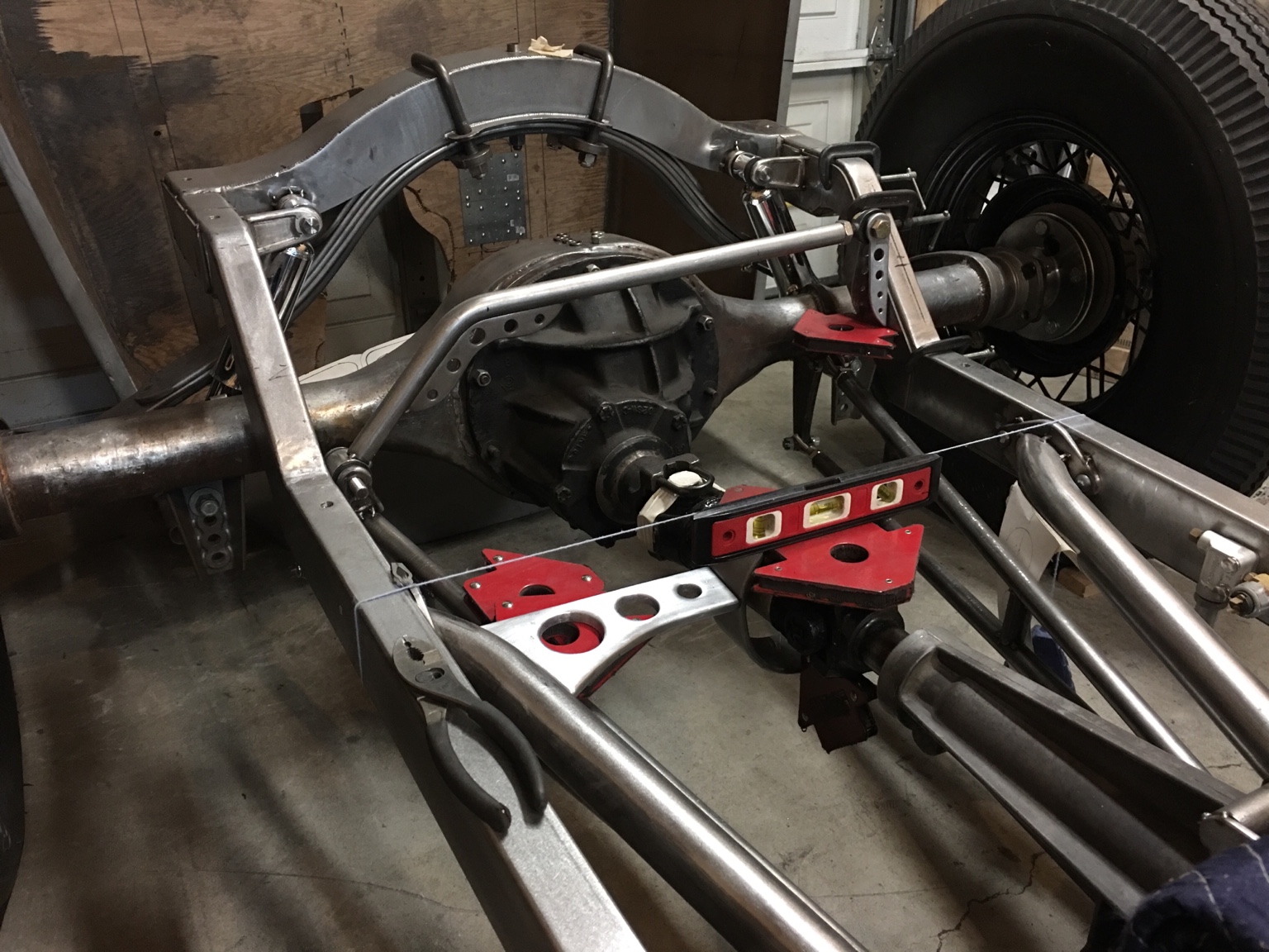

    Here is the panhard bar that I'm happy with.

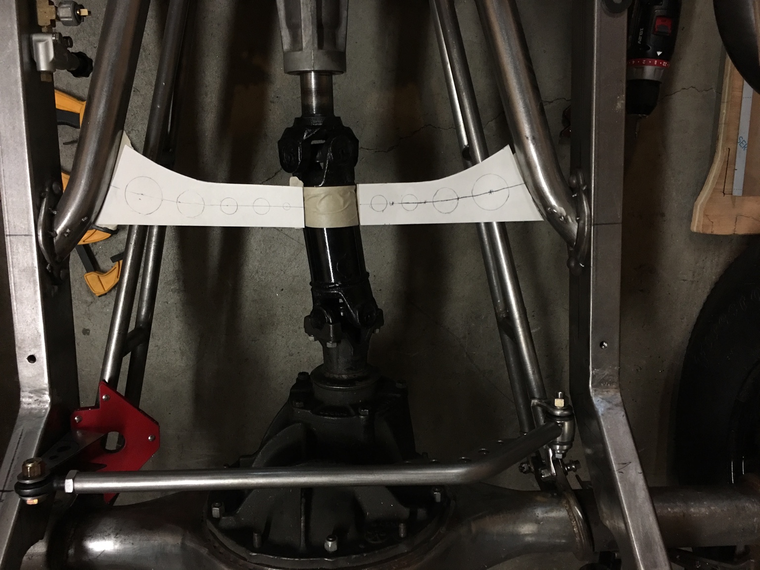

    And this is where I'm going with the driveshaft safety loop.
    This is the '58 283 that will be sacrificed for 302 cubic inches of awesome....looks more turd than awesome at the moment...
    And I have been slowly piecing together a decent collection of instrumentation for building the engine. Still need to snag a few items as the deals come along.
    That will do for now....

  8. loudbang
    Posts: 40,344
    Good stuff that is some NICE line routing. I add my vote for the dual quads back when we were kids every guy I knew wanted to have a car with dual quads when we grew up. Here's your chance for every boys dream to come true.

  9. Tim_with_a_T
    Posts: 1,656
    Tim_with_a_T
    Thanks! I purposely didn't show the scrap pile of tubing, but I did get a lot better as I went. When I was a Design Engineer doing piping and instrument drawings/designs, I was told that for tubing, to keep each run of tube with 3 bends or less so the shop guys fabricating could get it right without a lot of scrap. I was pretty proud when I pulled off this line, which has a couple more than three.... I did save that one for last, though LOL.
    I also got pretty decent with flaring the tubing. The key to all of this hot rod stuff is a lot of patience, a lot of repetition, not being afraid to screw up, and some decent tools (I by no means have the best, but I have used worse and it showed).

    My vote would definitely be the dual quads. Just a super-sanitary build by the way

    I'm normally in favor of the tri power, but I saw them A LOT this summer at the few shows I went to. The dual quads on a small block look good to me if the air cleaners are separate. The oval air cleaners look good, but they hide the carburetors! My favorite look of a small block is either the 'Vette dual quad or a stack injection setup, so when I finally got ahold of a pair of WCFB's that I could afford, I was pretty happy!

  22. Looks GREAT. I like everything you have done, nice work, well planed out. 2X4 set up looks great and tuned in, will be a great running system. I have run that set up multiple times over the years on SBC. When you stomp on it HOLD ON! LOL. Happy Thanksgiving Tim.

    As to Moon tanks on the front of street cars; very few of them look "right".
    As long as I'm handing out opinions, 2x4 gets my vote.

  30. 2OLD2FAST
    Joined: Feb 3, 2010
    Posts: 5,996
    2OLD2FAST
    from illinois
    Mounting the panad bar on the upper link of the ladder bar puts a lot of side load on that bars clevis , clevis' are not very strong being pressured from the side , might want to re-engineer that mounting ...
    dave
