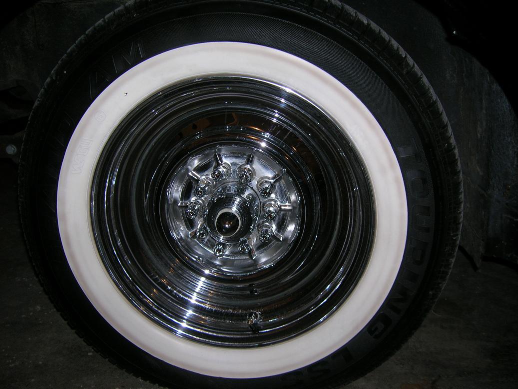

    so i just bought a 48 plymouth 2 door sedan and i want white walls but find the price rediculous since im trying to make this build quick and affordable on the shoe string. are these whitewall inserts that noticable as fake? i almost bought a 50 plymouth that had them but they were maybe 20 years old and didnt follow the tire lines due to age.

    Port a walls.Do what you can with the resources you have. They blow apart when used with Radials.

    My portawalls lasted about one summer before coming apart and I don't ever plan to use them again. Grinding sidewalls works nice, I've also had good luck painting wide whitewalls onto the sides of regular tires with snow seal, the white elastomeric trailer roof coating. I've heard people talk about using Krylon Fusion too, but I tried that and it didn't hold up for shit for me.

    StanLow is right ,Porto Walls will blow apart on radials .I know cuz i tried them once.They lasted about 1000 miles before they started to crack and fall apart .Grinding radials works and its cheap ,but i like the look of Bias Wide Whites on hotrods myself and just shelled out $604.00 for a set for my truck.There is just no way around it ,you get what you pay for .BTW i coulda spent the money in other places ,but i wanted Bias WW's so i saved up and bought them :)...

    Angle grinder with 36 grid disk followed by DA with 80 and 120. If you're really on budget, get some used ones at a salvage yard to practice on. You should be able to score decent useable tires for 10 to 20 bucks apiece. How much more low buck could you want?

    Guys, I have been running porta-walls for abou 6 years on the '56. Never any trouble and they fit nice against the (radial) tires. They are a German brand I found online called "Wegu". They must be pretty good quality because I just ain't that lucky.

    The 1 3/4 are good, ran em one my bug for a couple years, but anything larger than that, tend to flop off. If ya want anything bigger than an 1 3/4, i'd save some cash and get the real deal,IMO.

    i had a set on my car for over a year and have been well over 100 and there on radails and theres no problem... all has to do with brand and mounting...
